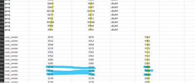

This solution works for me but I have a lot of duplicate choices.  Also, I have would have to write 74 different calculate rows.  Highlighted in yellow is the same information.  As you can see in blue the same answer can be used for 3 different selections.  Can Y802, Y812, and Y822 be combined to all relate to 3174? Currently if you selected all three of those gangs then 3174 shows up three times.

This is late, but you can make things appear under multiple options by using a comma-separated list, and that reduces duplicate lines
