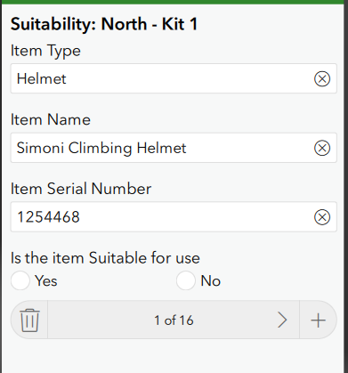

Im looking for something like the below where the first 3 questions are pre-filled through the 15-20 repeats depending on the region and kit you select and then the user just selecting suitability (and then adding further phto and text if required)

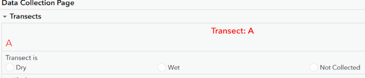

Here is how I do it to label the repeats A, B, C, etc.  May be more work for you with multiple options but I thought I would post it in case.  It could work where you calc the name of the csv to do the lookup to which I have for to work in another project.
See the red info getting auto filled.

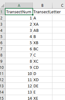

Then you have a csv that lines up the repeat number and the value.
