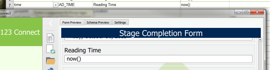

I can't seem to get now() to work. It just shows "now()" in the field rather than the current time. I tried to publish it thinking it would work once I view it on my device but it was the same. I tried it using both date and time types. I also tried to use time() but that didn't work either. Am I missing something or doing something wrong?
Thanks!!!!
Joseph_Kinyon
JD,
I am experiencing similar issues with date, time and datetime.
For date, use today() as the default function.
For time, it should be now(), but as of today I am confirming it does not work .
