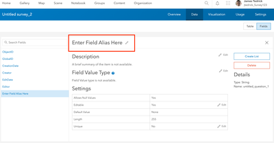

Can you provide details on how the names were placed in the XLSX file?  One thing that occurs to me is if they were copied from a rich text source (say, MS Word or copied from an HTML page), they may have HTML embedded that wasn't visible.  The HTML appears to come from a WPForms, which is a WordPress Forms plug-in (note the wpforms value in the name attribute).
You can alter the alias in the feature service's Item Details page - go to 'Data' and select the 'Fields' view. Click on the field you want to re-name and edit the name:

This is to be expected for the field aliases - your form labels have HTML and they are used directly as the field aliases when you publish a survey.  You can clean up the aliases using the Item Details page for the feature service.

Another question I have is how do I clean up aliases in the Item Details page? I do not see the option to do that.

Able to edit in the "data' tab, thanks!
