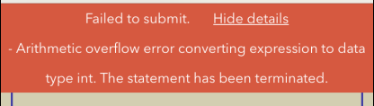

I published a survey that seemed to be working fine. Field crew were submitting completed surveys and using it. Then on several surveys, the app stopped working and they started getting the below error.

I am experiencing a similar issue; however, I did include an input mask.
Previously no error message but an issue with the integer format
In my case, my surveys had previously submitted with no error message. There was, however, a discrepancy with the manner in which the integer (masked as an US phone number) appeared in the Survey123 Connect for ArcGIS vs. the submitted survey in the Survey123 web application; in Connect, it appeared to be working just fine (123-123-1234), but in viewing the submitted survey in the Survey123 web application it appeared as 1,231,231,234.

Now receiving same error message as Stephane
Currently, I am receiving the same error message as Stephane.
When I check the Survey123 web application, the surveys are, indeed, not submitting. I am, however, receiving the emails that I had set up to send via MS Flow for when this survey is submitted.

Phone numbers should be stored as text, not integers.  If you ask for them as integers, the form will try to process '123-123-1234' and does not know how to handle the '-'.
