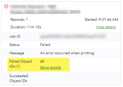

To find the failed job id, you need to go to the Survey123 Website Data page, open the report panel, click Recent tasks button on the bottom, and view the details of the failed task which will let you know the failed object ids:

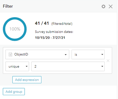

Then, you can use the filter tool on the data tab to filter the data.

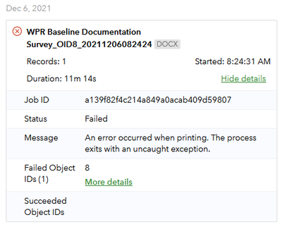

I have a Survey report template which is attempting to print 34 photos from inside a repeat. When we attempt to print the report, we get this error:
My end users did some testing on Friday and found that:
  • They were able to print a report with 1 photo
  • They  were able to print a report with 11 photos
  • They were NOT able to print a report if it had over 15 photos.
  • They cleared browser caches and tried again, but that did not help.
This morning I republished the Survey from Connect v. 3.13.234 and tried to generate the report again, however this also did not work. I also re-uploaded by report template to trigger the syntax checker, however the template did not throw any errors during upload.
The report template is structured to include information from both outside and inside the repeat (this survey has nested repeats). No maps are included in the output, just the photos and attribute information for them (which is stored in two places - the same table as the photo and a nested repeat).
