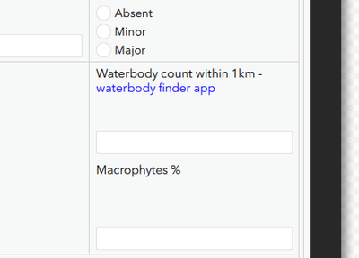

Hi all,
I have a note in my survey which I am hoping will present a hyperlink to a web app I have created. I have the label set as:
Waterbody count within 1km - <a href=https://delta-simons.maps.arcgis.com/apps/instant/nearby/index.html?appid=054f9701b6444053a50a2d19cd...>waterbody finder app</a>
However, when I click the link either in Connect or on my phone through the Survey 123 app, it goes to:
Does anyone know why it might be doing that?
Many thanks,
Ben
Tags (3)
BenBlowers2
I figured it out, the url needed " " wrapped around it! Now working 🙂
Waterbody count within 1km - <a href="https://delta-simons.maps.arcgis.com/apps/instant/nearby/index.html?appid=054f9701b6444053a50a2d19cd...">waterbody finder app</a>
