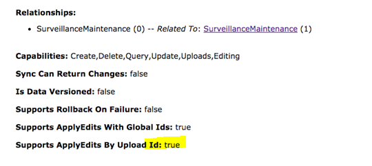

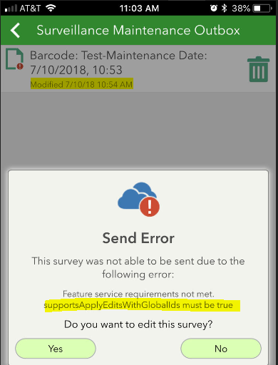

We have several Surveys created hosted in Portal 10.6, we were working fine with the configuration we have set until version 2.9.5 Once Survey for ArcGIS in our iPads update survey app automatically for Survey 3.0 and in that version we are getting error
and SupportsApplyEditswith GlobalIDs is set to true

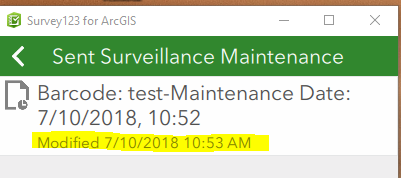

And with version 2.9.5 is working fine I was able to send the info
I am not able to downgrade my app from the iPads, how can I solved this this new version, is it supported for this version? @james tedrick

Feature Layers and supportsApplyEditsWithGlobalIds: Starting with version 3.0 you will no longer be able to submit surveys or publish/republish a survey against a feature service that does not have the supportsApplyEditsWithGlobalIds property set to true. While this requirement is not new, we previously only enforced it for surveys with repeats. It is therefore possible that your existing ArcGIS Online or ArcGIS Enterprise feature services don’t have this capability– so please check them to ensure that they will work when you update. The easiest way to enable this property is to simply enable the sync capability (Synchronization) on your feature service. Please follow instructions in the Allow offline editing or collaboration section of the Manage hosted feature layers—ArcGIS Online Help | ArcGIS help topic for details on how to enable the sync capability.  If working with ArcGIS Server, remember that you cannot turn on sync if your data is versioned or if your layer lacks an indexed GlobalID field.
https://community.esri.com/message/752500-re-survey-publishing-error-supportsapplyeditswithglobalids...
I my particular case I am using layers from our Enterprise Geodatabase so to fix this I needed to do the following:
  1. Enable archiving on the layer in the SDE
  2. Republish the service with sync enabled
  3. Republish the Survey from Survey123 Connect
  4. Delete the existing survey on the Device and logout of Survey123
  5. Hard reset the Device, there was some sort Cache thing going on
  6. Open Survey123 on the device, login in and re-download the survey
