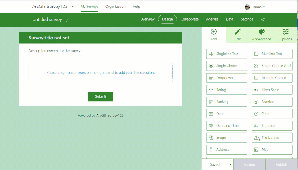

@WillvanHeerden   Good catch. This is a software defect. When using Survey123 web designer, conditional visibility rules are ignored by the address question.  Animation below shows how to repro.
I will send this to the dev team. However, you may want to open an official Esri Tech Support case for visibility.
IsmaelChivite
Esri Notable Contributor
Now logged as BUG-000143301 and scheduled for resolution with version 3.14
