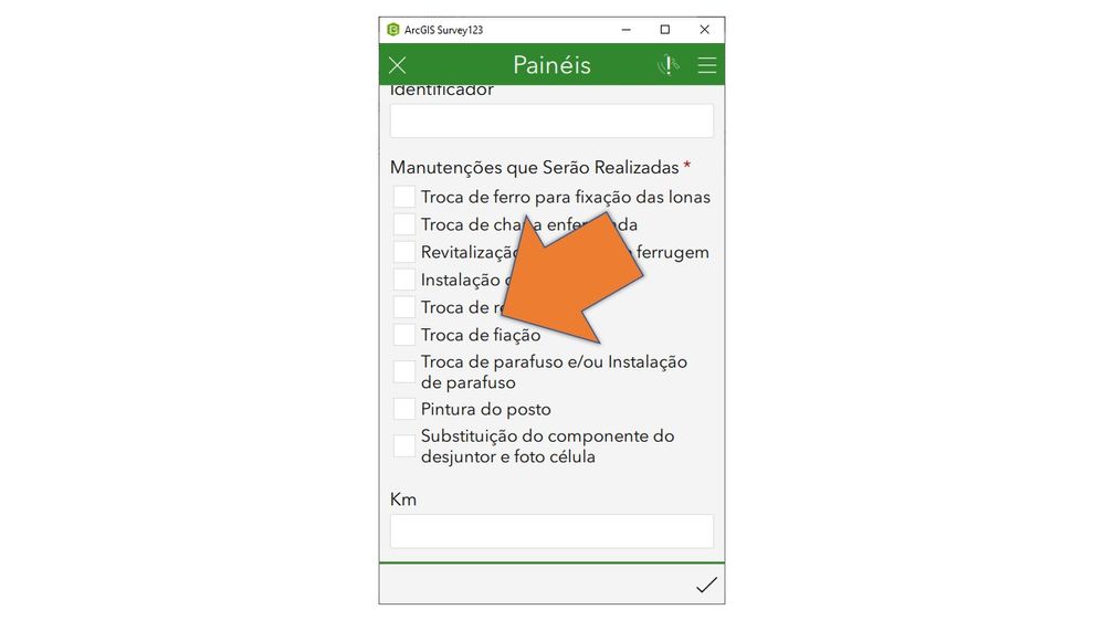

Hello,

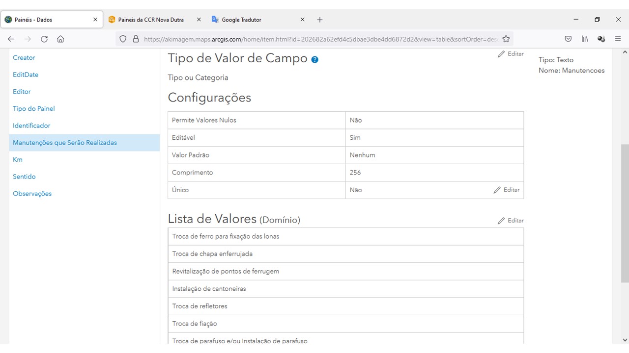

I have a layer of features called 'Panéis'.
A field called 'Manutencoes' on this layer has a list with several options:
- Troca de ferro para fixação das lonas
- Troca de chapa enferrujada
- Revitalização de pontos de ferrugem
- Instalação de cantoneiras
- Troca de refletores
- Troca de fiação
- Troca de parafuso e/ou Instalação de parafuso
- Pintura do posto
- Substituição do componente do desjuntor e foto célula

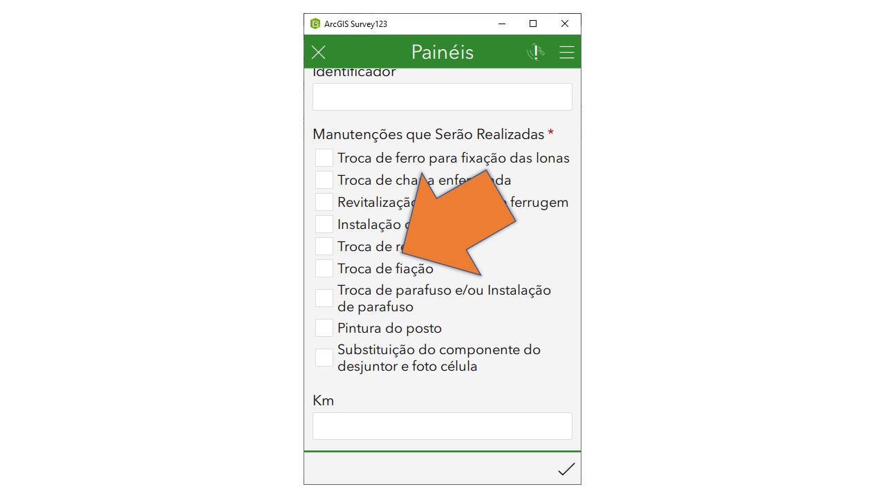

I used this feature layer to create a form in Survey123.

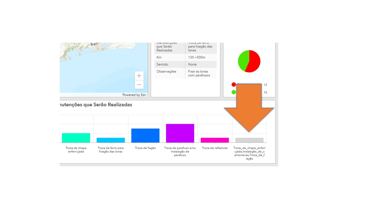

All options selected in the form are stored in the field 'Manutencoes', separated by ','.
When creating the chart in the dashboard, the options are not separated.
How can I separate the options the user selected in Survey123?
Regards, Diego

DougBrowning
MVP Esteemed Contributor
No way in the form.  Must post process.  Select multiple is a data pain for sure.
One cool way for charts is to use Ops Dashboard see an example here
https://www.esri.com/arcgis-blog/products/ops-dashboard/announcements/introducing-data-expressions-i...
Good luck
