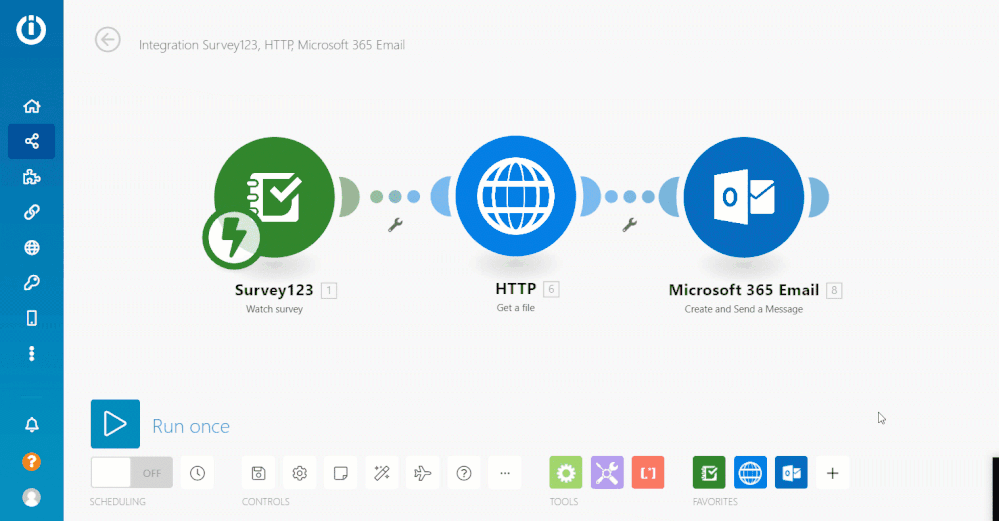

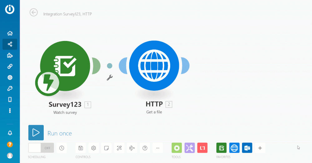

Downloading files with the Integromat HTTP module
Before you can work with Survey123 attachments in Integromat, you must download them first. The animation below shows how to use the HTTP module and its Get a file operation to download a Survey123 attachment.
 As you can tell from the animation, the Survey123 attachment URL is provided by the Survey123 module. If your survey feature layer is secured, you also need to provide a valid ArcGIS token, otherwise Integromat will not be able download the file. The token can also be fetched from the Survey123 module.
Once the file is downloaded, you can work with it. In the animation below the file is added into a new email message as an attachment.
Similarly, you could use other Integromat modules to upload the file into cloud storage, convert the file into another format or extract some file metadata.

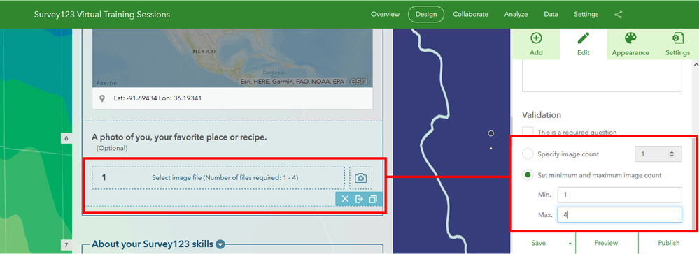

The scenario described so far is the simplest possible: A survey configured with a question where the user can only upload one photo or file.
As the author of a Survey123 smart form, you can decide how many photos or files should be uploaded with questions in your survey. The screenshot below shows an image question in the Survey123 designer configured for users to upload a minimum of 1 photo and a maximum of 4.
The blog post Survey123 tricks of the trade: Photos describes more advanced techniques to capture multiple files or photos with a single question using Survey123 Connect.

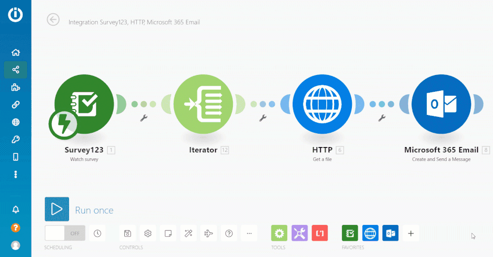

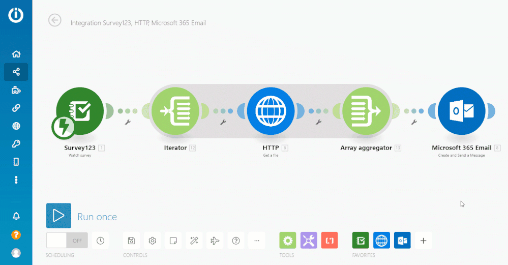

If a survey question is configured to accept more than one file or photo, you will want to use the Integromat Iterator and Array aggregator modules to handle the collection of files.
Attachment collections are modeled in the Survey123 module as arrays. Let’s have a look at how you can use the Iterator module to download multiple attachments.
Note that the Iterator module must be configured to target the array of attachments you want to process in the Survey123 module. Also, the Get a file operation will no longer target the attachment URL in the Survey123 module. Instead, it will target the attachment URL in the Iterator module.
If we were to run the Integromat scenario at this point, one email would be sent for every attachment found in the survey record. This is not what we want. We want to send a single email with multiple attachments in it. This is where the Array aggregator module comes into play.
 The key considerations to configure the Array aggregator are:
  • Set the Iterator as the source module.
  • Set the Target structure type to the module property that will receive the output of the Array aggregator. In our case, we want to use the aggregated array to populate the attachments property of the Microsoft 365 Email module.
  • When configuring how the target structure will be populated, make sure you use the Map option, so you can get the Data property from the HTTP Get a file operation and the File Name from the name property of the Iterator.
Note that as you finish configuring the Array aggregator, a gray indicator will wrap all the modules involved by the iterator. The Microsoft 365 Email module will be outside of that group, indicating that it will run only when the output of the Array aggregator is ready.
The next step is to have the Microsoft 365 Email module use the output structure of the Array aggregator to populate the email attachments.
 As shown in the animation, you need to enable the map option of the attachments property before you can target the output of the Array aggregator.

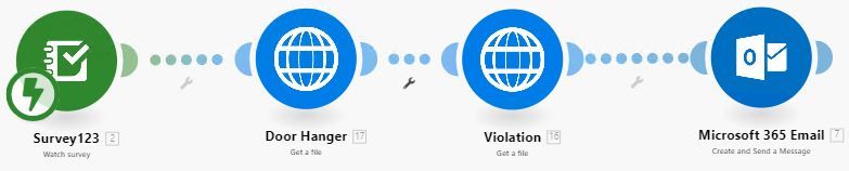

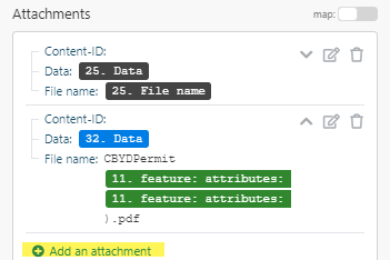

@Andrew-Bownehow is it configured in the email module?
I have 2 fields that collect attachments. I'd like to attach them all to a single email notification
  1. Gets a single file
  2. Gets multiple files
I can set up each one separately, but struggling to figure out how to do it in one scenario!
Andrew-Bowne
You should be able to add a new attachment to your email module.  The first one can get that single file, the second attachment can reference the array aggregator of multiple files.
Here is an example I use.  I am attaching two files: the first is a barcode image, the second is a PDF attachment.
While it's not exactly what you are doing, the concept should be the same.
DanteLee
I can do it that way if I have multiple single files, but no dice working with the array of multiple files and other single attachment like that. @IsmaelChivite?
Andrew-Bowne
I've got an idea.  I don't know if it'll work but could be worth a try....
Wrap each of your HTTP Get Modules in an iterator and aggregator.  You already have that for the second one so all you need to do is the first.  Yes, I know there is only one file, but it should create an array aggregator with just that file.
Then in the email merge both the arrays together in the attachments section.
merge(ArrayAggregator1;ArrayAggregator2)
See this link on Array Functions (merging).
https://support.integromat.com/hc/en-us/articles/360005771833-Array-Functions
DanteLee
Oh lordy - the merge function did it. 😵 I had some idea that's what I needed, but I was missing that piece! Thanks @Andrew-Bowne

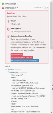

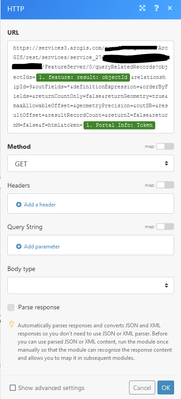

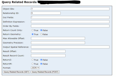

It's been a minute! I am trying to pull attachments from repeats and it is not as straight forward as I thought it was going to be. I have a report form that has a related point that allows users to drop locations of photos being taken while completing a site visit. This will later be used within a web builder application to show where photos have been taken and the direction they were taken. I had thought about using QuickCapture and the Oriented Imagery to do this, but I am trying to also use the Photographs as part of a custom report.
The data schema is a point for the initial report and a repeat with a geopoint with attachments applied (repeat relationship #9). There are several other repeats within the form, but none of them have attachments. In the past I have been able to complete
  1. HTTP Get request for the related records
  2. Parse the JSON
  3. Iterate through each related record
  4. HTTP Get request for the attachments of the related records
  5. Parse JSON
  6. Iterate through each attachment
  7. Save into OneDrive
At least that is how I remembered doing it a little over 2 years ago (I switched companies and couldn't bring existing materials with me, so I am relearning the processes) within Integromat. However, I am receiving an error once the scenario reaches the first Parse JSON and states "Not valid JSON".
To ensure I had the correct JSON, I went into the REST services page for the hosted feature service and generated the JSON using the (GET) method. I used this JSON to create the data structure for use within the Parse JSON module; just like I have in the past. I completed this same exercise for the querying of the attachments.
The JSON string being returned does not appear in the format that I would expect from the data structure.
Is there a new way of extracting the attachments from within a repeat? The only other thing that is bugging is that I thought at one point we had to declare parameters within the "Query String" of the HTTP request? Which would be everything after the "queryRelatedRecords?" portion of the URL?
Thanks in advance for any insight.
Mike
MichaelBruening
So, I had the "f" variable set to "html" instead of "json" within the query URL. I'm okay with it just being something that simple.

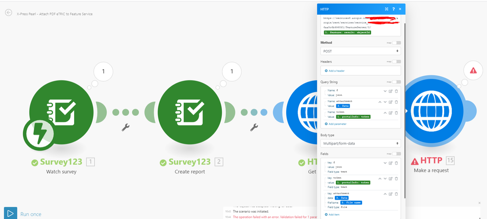

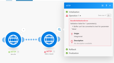

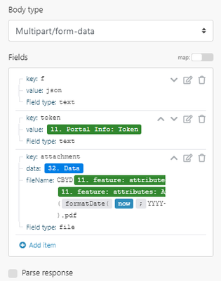

Has anyone tried attaching the Survey123 report to a feature in an online feature service, after using HTTP Get File request? This is something that we currently execute in a gp tool and we would like to transfer this to Integromat.
My Get File command works to attach the report in an email. But when I try doing an addAttachment request using the Rest API, it fails.
Andrew-Bowne
Yes, I am successfully doing this.  Your HTTP Make Request parameters are a bit off.  They should look something like this:
Make sure you specify the "Field type" Parameters.

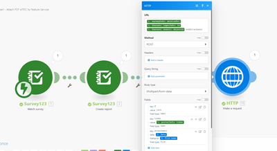

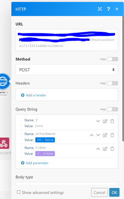

LiamHarrington-Missin
Hi @Andrew-Bowne  and @rachelm,
Excuse my noob status but what you are attempting to do is something I'd be keen to recreate.  However, without a full blown @IsmaelChivite type walkthrough I'm a bit lost.
Here is my attempt at doing what I think you are talking about using your screen grabs to guide me. The goal is to create a pdf report and then attach it to the source feature.  Very cool stuff.  I thought I was being clever by adding objectID to the URL to attach it to the correct "resource" but I think what I have done is broken it.
If one of you has a moment can you cast an expert eye over my attempt and tell me what I am doing wrong.  Thank you.
Andrew-Bowne
You're close...  really close.... in your Make Request, add: "/addAttachment" at the end of your URL.
If you wanted to kick it up a notch, you could use elements from the Watch Survey module's response to build your HTTP request.  Something like this:
rachelm
@LiamHarrington-Missin  also I removed the properties under the Query String section and only worked with the Fields section below Body Type.
Thanks @Andrew-Bowne for solution!
That did the Trick!
Thank you @rachelm  and @Andrew-Bowne.  For reference this is the working version.
