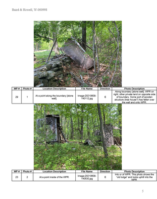

@Anonymous User -
With this new version, was there also some sort of automatic, behind the scenes change to photo attachment sizes? We have a survey which has not been republished at version 3.13 (it was last published with version 3.12 on August 16, 2021), however users are reporting a change in photo attachment sizing. We compared photo dimensions from before we updated to 3.13 and from after we updated.
Pre 3.13 photo dimensions were 1920 x 1440. Post 3.13 upgrade and photo dimensions are 1920 x 1080.
This is resulting in some squashed looking photos in our report template and when we export the full/original photo from the Survey123 website.
The only change is that our MDM has updated all devices to Survey123 v. 3.13.
Is there a way we can get back to the dimensions of 1920 x 1440?
Any assistance would be appreciated.
Erica
by Anonymous User
Not applicable
Hi @erica_poisson,
With the 3.13 release significant improvements were made to the in-built camera and also how image sizes are managed according to the survey image setting or using max-pixels on per image question basis. This also included fixes for maintaining EXIF information when images are selected from gallery and used with annotation, as well as fixes to the flash, zoom and orientation on front and back cameras.
In previous versions, there were several issues reported by users regarding the in-built camera, mostly that when setting the survey image size or max-pixels, the saved image was a different size, and that the camera always displayed at 4:3 ratio image, even though the device screen and camera supports a 16:9 ratio which fills the screen better. This resulted in black bars being displayed above/below viewfinder (in portrait) or to the left/right of image in viewfinder (in landscape). Users have been requesting that the image viewfinder fill this available space by using a 16:9 image versus a more square 4:3 image, one of our most requested issues with the in-built camera.
The 3.13 improvements now select the most suitable aspect ratio based on the device screen size, so it will try to adjust the viewfinder to find the best resolution that the camera supports and that matches the resolution set by the survey or max-pixels. On most devices, if you have set 1920 as the survey image size, when you go to take the photo, there will generally be at least two options available,  1920x1080 (16:9) and 1920x1440 (4:3). Depending on the device you are using and screen size, either of one will be used that best fills the devices viewfinder. In fact, the camera often reports other sizes that are different aspect ratios altogether, there can be up to 5 diffferent 1920 sizes on an iOS and Android device, depending on the model and camera hardware.
Based on the devices you are using, it appears that 16:9 fits the screen better. Are you able to modify your report template to display the entire image in a suitable size that fits the area you are trying to display it in without squashing it? Canyou send a screenshot, or provide your report template and the images capture, so we can take a further look?
As for exporting the images from Survey123 website, how are you doing this? Are you saying that after you export the images and open them in other software on a desktop (image preview or photoshop etc) they look squashed also? Can you provide a screenshot or example of this?
Hope this helps.
Regards,
Phil.
erica_poisson
Occasional Contributor III
@Anonymous User
Thank you for that really detailed information. The user who reported this is using a new iPad Mini. The workflow is for our Conservation Easement monitoring and she had me size the photos for the report template so that all of our monitors didn't have to manually re-size full-sized photos once exported to Word. This is the syntax I am using within the report template right now:
${ Related_Table_Photo_Information.Image | size:450:0}
With that sizing, it came in so that we could fit two images and tables per page of our report, which is our organization's standard for these reports.
Here is what the photo section of the report looked like pre-3.13:
Here is what it looks like post-3.13 (iPad Mini):
When I go to the Survey123 website and visit the 'data' page for this survey, I save the image by finding it in "form view", I click to view and then I click the download option in the upper right corner of the image. When I bring this into a report manually, I still can't replicate the size because the aspect ratio is different.
Personally I don't think this is a huge deal. It doesn't seem like there is much we can do about this if this was a fundamental change to how Survey123 deals with the camera/photos. It seems like I might want to play with the sizing I specify in the report template to see if I can get the photos to not look squashed. I will pass on the great information you shared above to my user.
Thank you,
Erica
