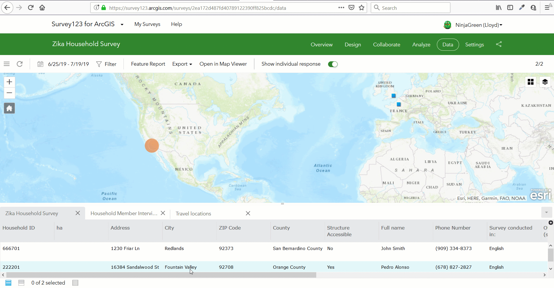

  1. In the Survey123 website, go to the Data tab of your survey.
  2. Select one record from the table or the map.
  3. Click on Feature Report in the top bar

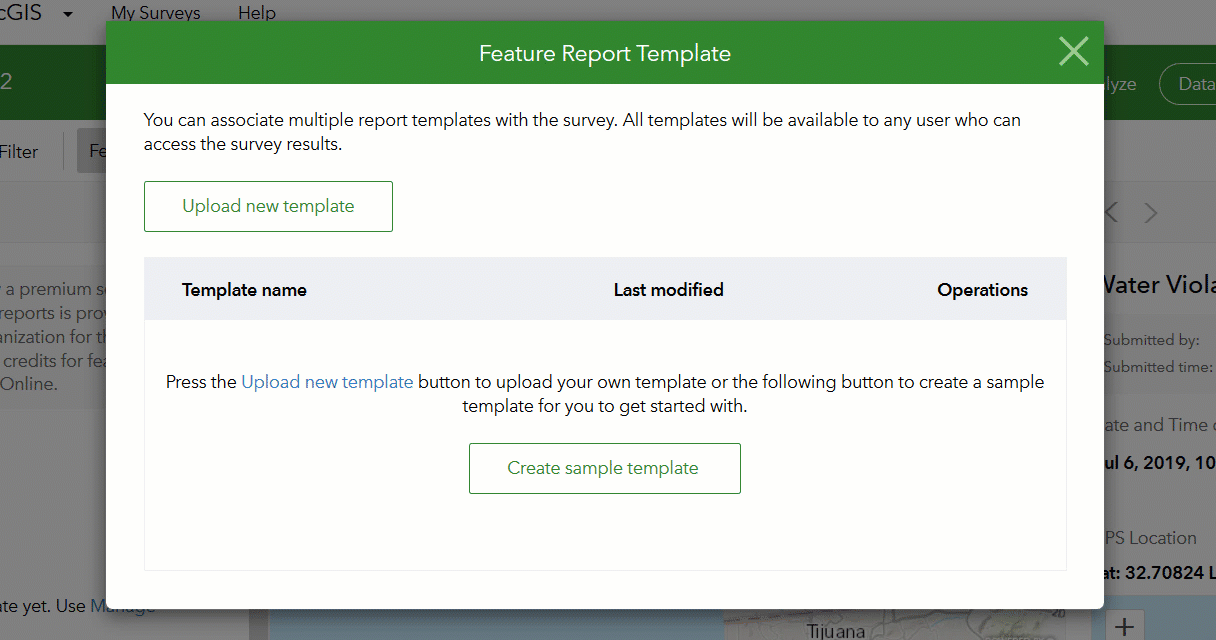

  4. In the Feature Report panel that just open on the left side, click on the Manage Templates link.
  5. Create a new sample template as shown in the animation below and close the dialog.

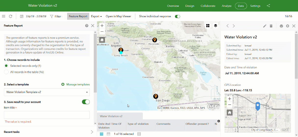

  6. Generate a report.
Now that you have a template, click on the Generate Report button and open the resulting output document.  The sample template is generated automatically, and as such, will not create the most beautiful results, but it is a great starting point for you to refine it.

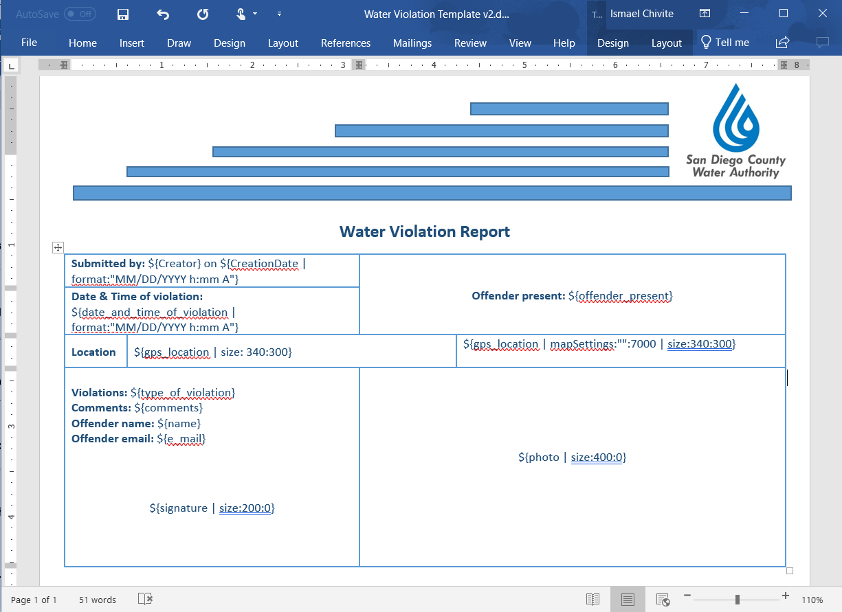

Going back to the Manage Templates link you will be able to download the sample template to your computer.  Once you download the template, you will realize that it is a simple Microsoft Word document. This is what the sample template for my Water Violation v2 survey looks like:

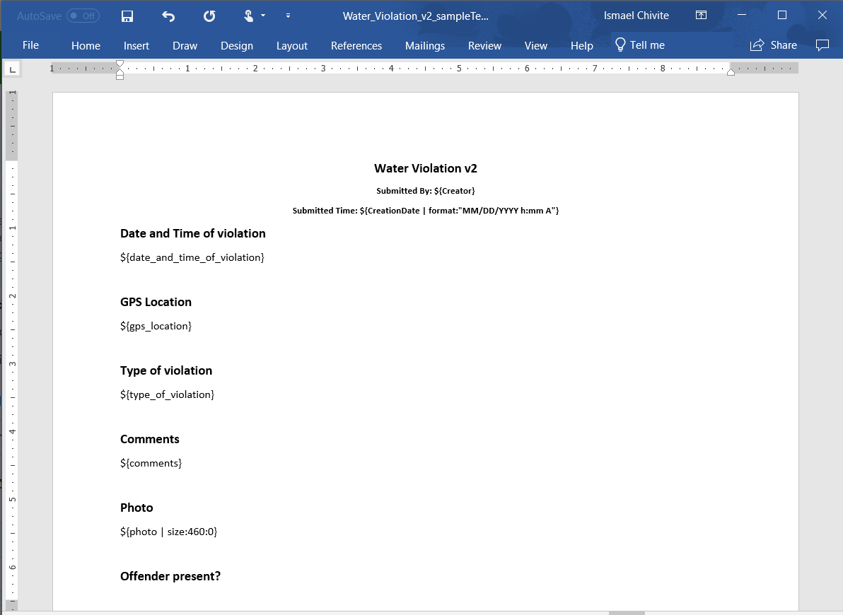

You can see right away how templates work: A series of placeholders for questions in your form are included in the template. The most basic syntax for the placeholders looks like ${question_name}. All you need to do is to make your Microsoft Word template document look the way you want and insert the Survey123 feature report placeholders accordingly.
Once you are happy with your report template, you can upload it using the Manage Templates link.  Until you get familiar with the placeholder syntax, I suggest you start easy: Start by rearranging text within the document and copying and pasting the placeholders from the sample template. Change the color and style of the text, arrange existing placeholders within tables, etc.
Generate a report again with your updated template to see the effect.
Using advanced feature report syntax
Survey123 feature report syntax can get a bit more sophisticated than just a generic ${question_name}. For example, note in the example below how extra parameters are used to format dates, to control the size of a photo or signature and even to define the scale and contents of a map.
This is what the final output of the template above looks like when the report has been generated.

You can insert a | sign after your question name (aka: field code) and include some extra parameters to either format the value written to the report, or extract other information from your survey question.
Feature Report Syntax Description
${myquestion}Inserts  in your report the value stored in the specified survey question.
${mydatequestion | format:"DD/MM HH:mm"}Date questions are tricky, because they will not come pretty unless you format them properly. The format parameter is your friend. For a complete reference look for the Formatting Dates section in our Formulas—Survey123 for ArcGIS | ArcGIS help topic.
${myphoto | size:300:0}
When working with image questions, you can set the exact size in pixels that the image will have in the output report document. The first value defines the width and the second the height. If you set the height to 0, then the width will be applied and the height will be dynamically set so your image aspect ratio is preserved.
If you want to display the photo at full resolution use ${myphoto | getValue:””}
${myphoto | getValue:"name"}
${myphoto | getValue:"date"}
${myphoto | getValue:"time"}
Also for image questions, you can add to your report the photo filename using the getValue:"name" parameter. Similarly, you can also extract the date and time when the photo was taken and have it written in your report. That, of course, assuming that the EXIF of the photo includes that info.
${mylocat | size:400:400}The size parameter is valid for map questions too. In this case, we will add in the report  map with a size of 400x400 pixels.
${mylocat | mapSettings:"6712da572":5000}
${mylocat | mapSettings:"":5000}
Use the mapSettings parameter to describe the exact webmap you want to draw and the map scale.  First you pass the webmap item id and then, separated by a colon, the map scale. If you do not know how to get the webmap item id, have a look at Lisa Berry's  Where can I find the item ID for an ArcGIS Online item? blog post. If you pass an empty webmap item id, then the report will use a default webmap.
${mychoicequestion | selected:"yes"} Yes
When working with choice questions you can use the selected parameter to output a checkbox. The expression on the left will output Yes if the option selected is yes.  This works well with both checklists (select_multiple) and single choice and dropdown questions (select_one).
Combining your mastery of the syntax above and a bit of good taste applying layouts and formatting in Microsoft Word will go a long way. You can pretty much do anything you want with your Microsoft Word document. For example, you can change the size and orientation of the page, use tables to arrange content, set the alignment and justification of text, its color, size, etc.  You can also include Survey123 placeholders in headers, footers or anywhere in the body of your document.
As you get started with the feature report syntax, I suggest that you start slowly, making small incremental changes against the sample template and you let your confidence grow progressively. You will need to upload your template again and again until things look they way you want. Every time you upload the template, the syntax of your report template will be validated.  You will get errors when you add an incorrect number of parameters on your placeholders, when you reference field codes that do not exist in your feature service or when you do not open or close the brackets correctly.  Also be careful making sure parameters are set with the right casing and honor the necessary spaces.
