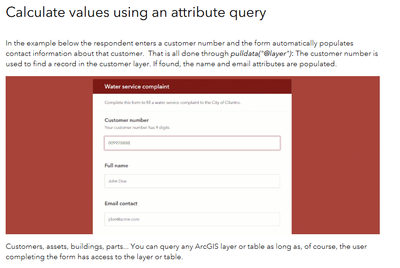

Calculate values using an attribute query
In the example below the respondent enters a customer number and the form automatically populates contact information about that customer.  That is all done through pulldata("@layer"): The customer number is used to find a record in the customer layer. If found, the name and email attributes are populated.
Customers, assets, buildings, parts... You can query any ArcGIS layer or table as long as, of course, the user completing the form has access to the layer or table.
