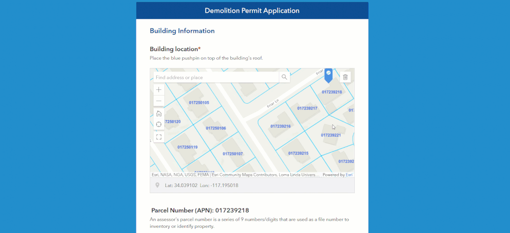

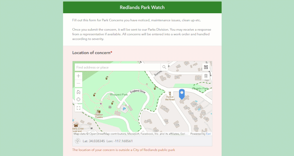

Point-in-polygon calculations using a map
The animation below shows a typical scenario for pulldata("@layer"). A calculation takes the location set in the map, and triggers a point-in-polygon query to retrieve a value from the intersecting polygon; a parcel's APN (Assessor Parcel Number) in this case.
I can think of a gazillion cases where point-in-polygon queries will be handy... just think of the polygon layers you may have: parcels, soils, fire perimeters, sales territories, evacuation zones, city boundaries...

Point-in-polygon queries for data validation
You can use the output of pulldata("@layer") to calculate a value, like in the examples above, or to feed a data validation rule. In the next animation, a point-in-polygon query checks if a reported incident falls within a City of Redlands public park. If it does, the report is accepted. If it does not, the user will not be able to submit the form.
Again, we are essentially doing a point-in-polygon query using pulldata("@layer"). In this case, the output of the query is used to check the integrity of the data.

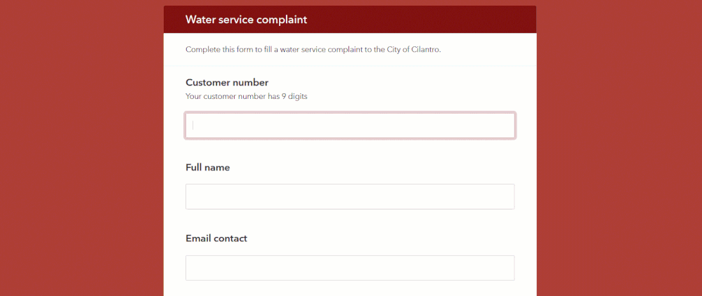

Calculate values using an attribute query
In the example below the respondent enters a customer number and the form automatically populates contact information about that customer.  That is all done through pulldata("@layer"): The customer number is used to find a record in the customer layer. If found, the name and email attributes are populated.
Customers, assets, buildings, parts... You can query any ArcGIS layer or table as long as, of course, the user completing the form has access to the layer or table.

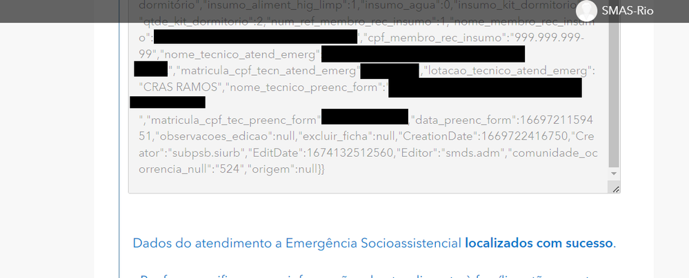

SMDSAdministrador

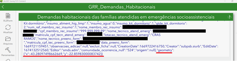

Is there any way to return the X and Y spatial attributes in a web form (and then calculate the geopoint)?
I manage to make it work in the Connect preview, however, when publishing the form, the query does not return the spatial ("geometry") part of the layer. I'm using a query like "GetRecord" and calculating a series of other fields with "@json".
Is it some configuration in the query layer that I'm missing?
Image 1: Geometry attributes returned in Connect
Image 2: Geometry Attributes DO NOT appear on the web form

I need the same functionality as the Redland Parks example, where I only want the point added if within a specific polygon buffer feature service. I use the same polygon feature service to populate a Name feature in the new point feature but I can’t find a good example of the location constraint.

Hi @IsmaelChivite,
Comment/praise: The pulldata function is an incredible advancement in the Survey123 application and has allowed me to simplify & automate tasks for our field crews as well as provide actionable data to our dashboards. Thank you so much for getting it to us and the great tutorials you provide us all with as well as the huge amount of interaction with us all in the comments.
Question: Is there a way to omit the “geometry” portion of the JSON response to the pulldata("@layer", "getRecordAt") function?
Background: I am pulling in four attributes from a polygon layer.  I am trying to be a “good citizen” and use getRecordAt and then parse the JSON. While this only uses the single http request, it returns a massive amount of text because of the complexities of the parcels. My worst example is the JSON character length of the attribute table is 432 characters, however with the geometry in the JSON it jumps to 283,497 characters. Since we have to name the JSON field to call it and parse it in the form, it is being submitted with the form. The text file of that JSON payload is 277 KB. That is the size of a screenshot image.  I am trying to develop in a sustainable manner and use as little computational power as possible in my form design, however at this point it seems like it may be less “expensive” to do four separate “getValueAt” http calls instead of one “getRecordAt” because of the size of the “geometry” field in the text, along with the data pulling and sending because of that field.  Can you please offer up what you would do?
JSON Example: {"attributes":{"OBJECTID":299,"BLDGID":3800,"Bldg_Name":"Example Building Name","Division":"Example Division","Division_Desc":"Example Division Description","MGRName":"Example Manager Name","MGR_Email":"MGR@example.com","Inspector":"Example Inspector","Inspector_Email":"Inspector@example.com","Inspector2":"","Inspector2_Email":null,"GlobalID":"Example Global ID","Shape__Area":69298158.71875,"Shape__Length":320926.140389049},"geometry":{"rings":[[[-155.5473912242,20.1245537142841],[-155.547158159892,20.1243830894184],[-155.546994967446,20.1243059910649],[-155.546686150906,20.1242564514348],[-155.546365653572,20.1243059497348],[-155.545998568709,20.1243004089693],[-155.545794614309,20.1242563088881],[-155.545707199249,20.1242068265984],[-155.54558486847,20.12409672054],[-155.545532430214,20.1239756779275],[-155.545433417005,20.1238711057396],[-155.545217839303,20.1237114233726],[-…
Thank you,
Jared

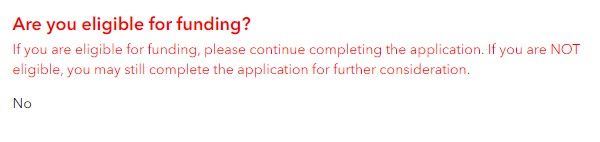

Hi @IsmaelChivite
Is it possible to have the data that is pulled into my survey to be bolded and bigger? Can I add basic html to the calculation column in survey123 connect that will make this happen?
See attached screenshot of what I'm talking about. I want the "No" to be bigger and bolded text.Areyoueligible.jpgThanks in advance!
RobertAnderson3
MVP Regular Contributor
Hi @AmandaBeck
Directly in the question itself I'm not sure, I think the HTML will only really display in a question label, so what I might suggest is calculating the yes/no in a hidden field and then in a NOTE type field (which you could set to fieldType null so it doesn't store extra data in your layer) set the label to have the HTML and then ${question} in the label. Like <b><font color="red"font size = "4">${question}</font></b>
Or you could include the HTML in the calculation so you can have different HTML for yes or no.
if(condition,"<b><font color="green"font size = "4">Yes</font></b>",<b><font color="red"font size = "4">No</font></b>)

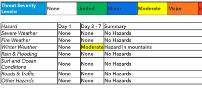

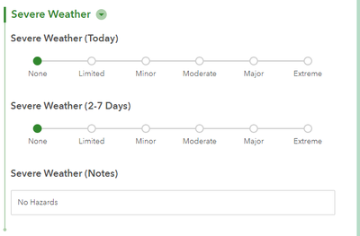

Hi all! I am hoping to do something like what is shown in the 'Count records in a table or layer' sample.
What I am interested in doing is creating a single select question with 3 options (A, B, and C), but limit the amount of times each can be picked. For example, I only want option A to be submitted to 10 times, B 15, and C unlimited. Then show a note that the option you selected is no longer available and to stop from submitting the survey.
I know this would be possible using pulldata, but I don't know how to execute it. Is there anyone who has done something similar and would be able to provide some guidance? The layer I need to reference would be the one the survey makes.

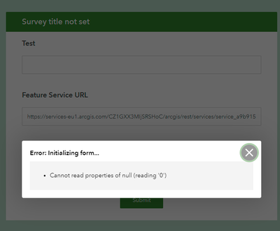

I tried your first 2 answers and unfortunally the Survey doesn’t ´pull any results. it doesn't give me any error though, but the field remains empty.
Your third answer I am not dure what field I should put instead of your ${status}. But please let me know if I got the pulldata("@layer") function correctly: I got LAYER1 which is the database of all employees and from which I need to know the number of active ones. Then I got LAVER2, which is my survey123 Layer in which I want the count of employees to be pulled in, in order for me to calculate the illness rate…
When I open the survey in the Web I got this message:
Any ideas what am I missing out??
