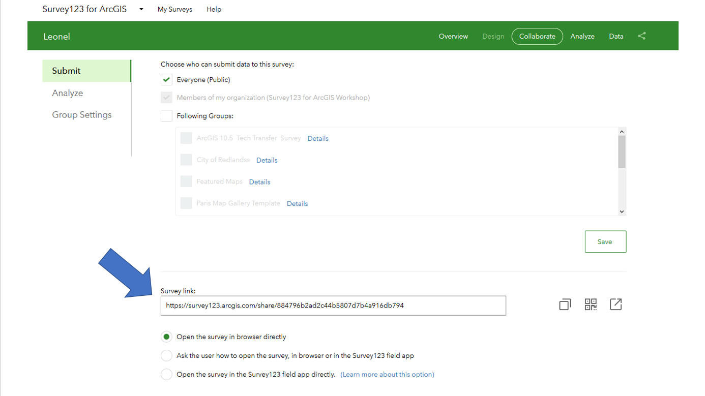

You can open any survey you have published from a web browser by simply using the links provided in the Collaborate tab of the Survey123 web site.
The above will not take you by surprise, because we have supported Web Forms since June 2016. So what is new?
