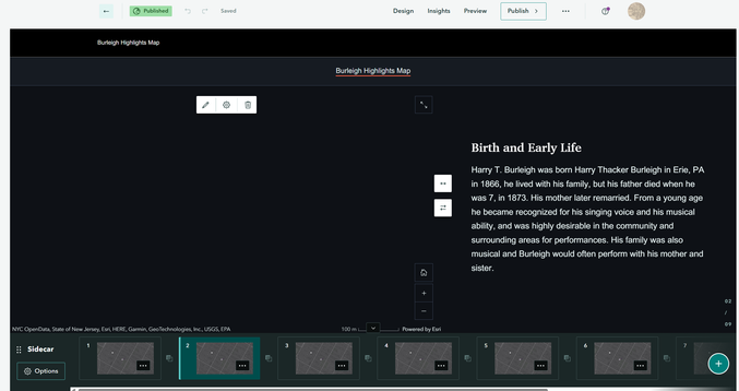

This video clip might be another good example - I'm trying to create a sidecar with a map, and there is a little map snapshot at the bottom. If I go from one slide to another, it won't update the map snapshot to reflect where I actually am on the map (but looks fine in the editor). It seems to get stuck on the previous  slide of data. I can go to Editor mode and try and resave it to the right location, but it always seems to just get stuck on the previous slide:

@SaraJL - The thumbnails in the bottom of the sidecar builder have never updated to show the configured map view, so that is expected. Those thumbnails only show the thumbnail from the map's item details. They are meant as an indicator of what type of content you have in that slide, but do not show you the exact map view if you have updated it by toggling layers or changing the zoom/extent.

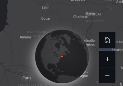

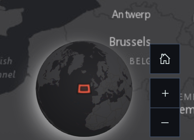

SaraJL
Not the thumbnails for the sidecar tiles - I'm talking about the globe snapshot map.
Mine looks like this:
It should look like this:
OwenGeo
Esri Notable Contributor
@SaraJL - Oh, I see. Sorry for the misunderstanding. That could be a bug with the overview map that we can try to look into, but I don't see that map from your video in the story link you shared above. Is that something you could share?
