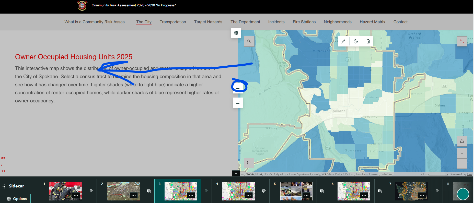

2) In the slides for a Sidecar I'd like to be able to change the size of the panels individually without altering the size for entire storymap. Is this possible? For example, I want to make the map on the right bigger, but when I do this it resizes every single slide to match.

2) As you navigate through a sidecar, the content for each slide scrolls into the same area as the previous slide, so you aren't able change the size or position of individual slides. If you want a different panel size for consecutive slides, you can try breaking the sidecar up into multiple, consecutive sidecar blocks, each with a different panel size. The easiest way to do this is to duplicate the sidecar and then remove the slides you don't need in each one.
