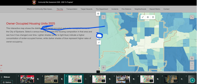

2) In the slides for a Sidecar I'd like to be able to change the size of the panels individually without altering the size for entire storymap. Is this possible? For example, I want to make the map on the right bigger, but when I do this it resizes every single slide to match.

2) As you navigate through a sidecar, the content for each slide scrolls into the same area as the previous slide, so you aren't able change the size or position of individual slides. If you want a different panel size for consecutive slides, you can try breaking the sidecar up into multiple, consecutive sidecar blocks, each with a different panel size. The easiest way to do this is to duplicate the sidecar and then remove the slides you don't need in each one.

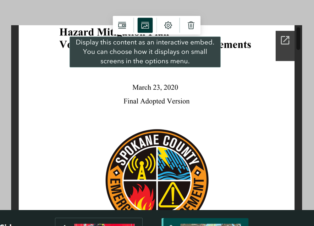

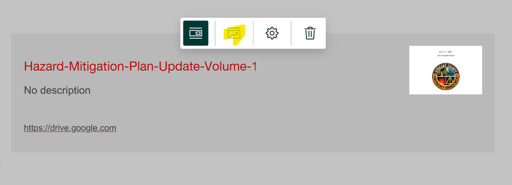

But that doesn't work. I'm going to send some screenshots of this (1st photo) and also my working live embed with a simple/typical URL that's been there for years (2nd and 3rd photos). So I'm confused as to why it used to have no problem with the URL type, and is still working, and I've tried a number of different PDFs with no luck on getting the "live" aspect to work. liveembed1.pngliveembed2.pngliveembed3.png

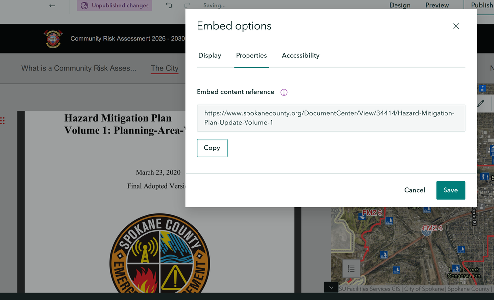

That existing PDF is shown in the story because it is being loaded using the Google Drive PDF viewer URL; it is not being directly embedded from the .org website. The URL reported in Embed options > Properties is not the full URL that is being used to view the content. It is the URL of the original PDF file extracted from the Google Drive URL parameter.
Although I can't tell for sure, it appears that the Google Drive URL is what was used to originally add this to the story. Please note that embedding the PDF using the Google URL that I mentioned above does still work. It sometimes takes a very long time (I've seen 30+ seconds) for the PDF to initially appear in the story, but we have verified that it does work. I am not familiar with this viewer, so can't comment on how it works, why it might be slow, or whether permission/licensing is required to use it.
I believe the fact that one of the PDFs is working like you expect has led you to believe that the PDFs on the .org site meets the security requirements, but they do not. The .org website does not have the proper security headers to enable it to be directly embedded.

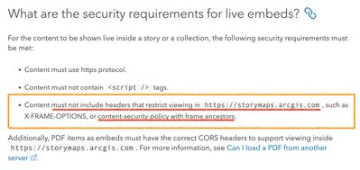

Here is the pertinent part of the FAQ I mentioned above that describes the security requirements:
And here is the header from one of the PDFs on the .org website showing "frame-ancestors" that does not include *.arcgis.com or some variation of it. The web admin would need to make changes on the website to modify the CSP (content security policy) to allow the PDF files to be directly embedded on other any other website or explicitly allow embedding on the ArcGIS Online domain (storymaps.arcgis.com, or *.arcgis.com).
