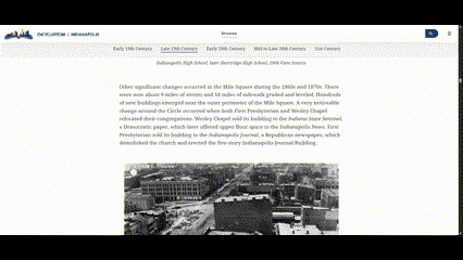

I'm working on embedding my organization's StoryMaps via the new script method. I've managed to do this successfully with a few of our StoryMaps but have run into a snag with our StoryMaps that use the image gallery block.
When embedding with the iframe option, they work fine. However, when I use the script embed option, the image gallery appears to be animated and moving in a loop. I'm not sure how to fix this.

@indyencyclopedia -- Thank you for reporting this issue. It looks like some of the overall page CSS is affecting elements in the story, possibly some transition animations. We are looking into this, but it is very tricky to try to isolate, so I don't know the timeline on a possible solution. Can you provide a link to your page so we can take a closer look.
I would recommend that you try to look into it on your end to see if you can figure out what CSS class is causing the issue and remove/override it on your end or maybe remove some of the transition animations on the page. Please post back here if you do figure it out. Otherwise, you could also try to use a different image gallery layout (like jigsaw) to see if that fixes it or you may have to remove the gallery for now.

@indyencyclopedia - I believe we have isolated the issue and we are working on a fix. We hope to release it in an upcoming deployment next month.
