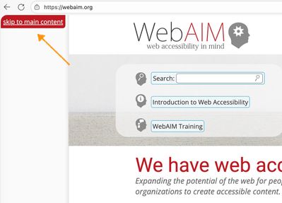

@PK6 -- Thanks for contacting us about this. The "skip to content" button is a standard part of many web sites and web pages. See this site, for example: WebAIM: Web Accessibility In Mind
Screenshot 2026-02-05 at 10.26.37 AM.jpgScreenshot 2026-02-05 at 10.26.37 AM.jpg
Can you share a bit more about why you want to remove or change this button? I'm not sure what you were referring to by the text "outlined in red." Did you perhaps forget to add a screenshot?
