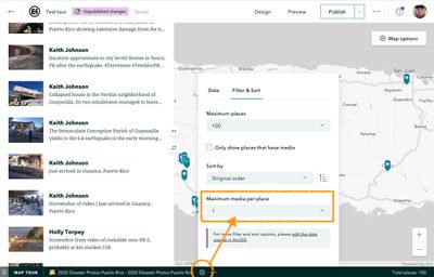

Hello everyone,
I have a story map tour setup using an existing feature service which has multiple attachments per feature (see attached). Based on the guidance provided in the March 2021 update, it sounds like up to five attachments are now supported with existing feature services. I have tried all of the different map tour formats and looked for options to enable multiple attachment, but couldn't get it work. Has anyone gotten this to work for them? What do I need to do for the story map to show multiple attachments?
Thank you in advanced for the help!
Nick
OwenGeo
Esri Notable Contributor
@nspittlemeister_LCFPD That's in the Filter and Sort tab of the tour data options (the gear at the bottom)
@OwenGeo Got it, thank you for the help!
