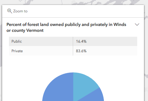

Issue 2) Second issue is that my pie chart is not sized correctly when first displayed. First time my pop-up appears the pie chart appears rather small. But if I select a different county that pop-up will display correctly. Every pop-up within that same map will be displayed correctly.

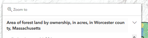

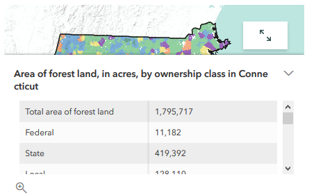

Issue 3) Third issue, and this actually spreads across all maps in StoryMaps. Titles for pop-ups do no space correctly. For instance,
Slideshow
I've noticed this in other maps as well whether the were in text, sidecar, or slideshow.
Sidecar
In text

Hi Bryan - Thanks for providing this feedback. We'll look into issues 2 and 3. Could you share a link to the story and web map you're using so we can take a look? I can't reproduce the issue with the pie chart being a different size at first.

I took out the pie chart because of the issue but it was the Public Land Ownership layer I had it in.
