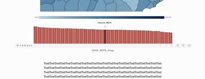

@TimSchock__PASDC -- Just to add to my previous message, no action on your part is needed. The specific issue is that sizing parameters that were included with embeds added as iframes are no longer being honored.
I tested your story with our dev code and it fixes the issue (screenshot below).
