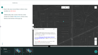

This is not currently a feature that is built into the StoryMaps Text element. The closest to grabbing the data would be via pop-ups using arcade expressions within a web map that is then brought into the story in an immersive element, like a sidecar or map tour (check out these blog posts for more information on how to set this up 1 , 2 ). The extent of the specific slide or point in the immersive element could be limited to that specific point, and the pop-up could be left open by turning on "Keep pop-up open" in the story's map options, and additionally docked with the "Docked pop-up option".

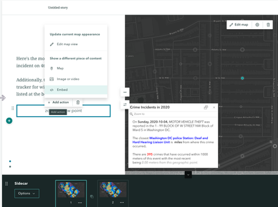

Another option I can think of, is adding a map action button in an immersive narrative panel to allow the map content to either jump to a particular pop-up that has the arcade expression configured, or to an embed of another piece of content, like a dashboard, that is showing the live update of the data.
