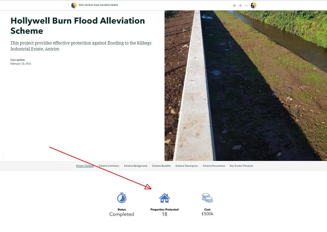

Within this Story map I have a section which allows the user to view individual Story Maps for each project.  Below is an example screenshot
https://storymaps.arcgis.com/stories/5a5365eabb7d4897b8f6b5c16ac68db9
The section indicated is manually updated using an image from Powerpoint, so needs replaced whenever any of the values change.  The values are actually store as attributes of a feature class, and I'd thought to replace the image with a simple 'Experience' that includes a map and a banner that automatically updates whenever the attributes are changed... and I wanted to use the same Experience in all project Story Maps, but to utilise URL parameters to present the pin for the correct project and populate the banner with the correct values appropriate for that project.

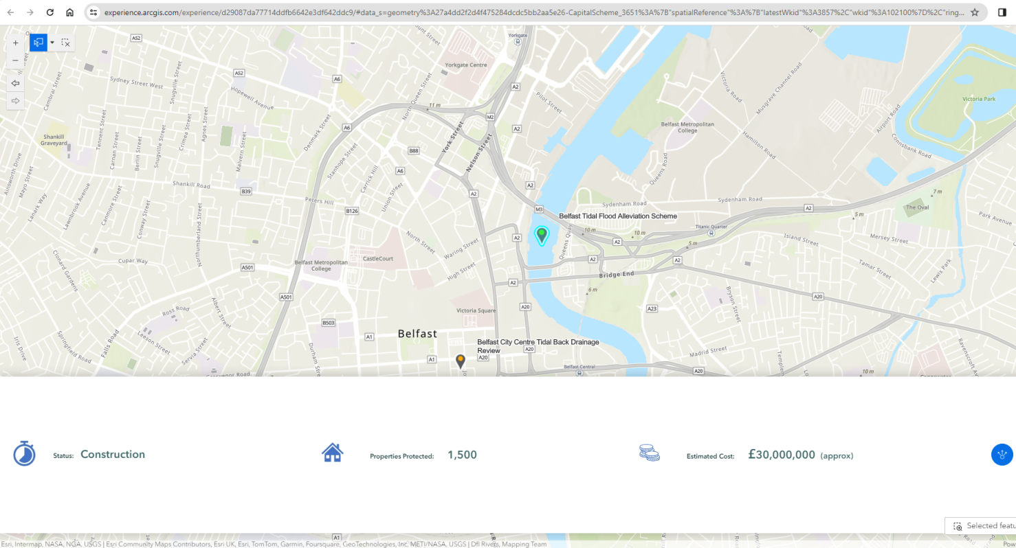

and  when I select a project the banner looks like screenshot below... the URL changes once I select a project pin and the attributes in the banner get populated.

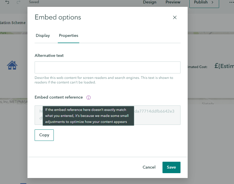

However, when I go to my Project Story Map and use the [Embed] option to add the section in, what appears to happen is that the Embed widget simplifies the Story Map properties, so that the URL with all the 'project specific' detail is lost i.e. map in wrong place, no stats in banner, which behaviour seems to be confirmed whenever I examine the Embed Properties (see screenshot below).

I don't have a solution for you. Only an explanation.
I've found that the StoryMap embed block strips fragments from your URL. So the content with the "#" in your Experience Builder URL is removed.
Unfortunately, that fragment is what Experience Builder is using to indicate it should be opened with the specified feature selected (see the Select data section in Use URL parameters.)

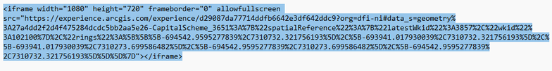

Hi, when I use the 'long URL' the embedded experience presents the attributes for the selected feature, however it doesn't zoom to the selected feature.. but instead the embed presents the default map extent.
Previously I'd thought that the 'zoom to selected feature' had been working.. but its not working now.
The embed code I'm using is as follows:
DfIRivers_0-1711446520017.pngDfIRivers_0-1711446520017.png<iframe width="1080" height="720" frameborder="0" allowfullscreen src="https://experience.arcgis.com/experience/d29087da77714ddfb6642e3df642ddc9?org=dfi-ni#data_s=geometry..."></iframe>
which is being carried across to the properties of the Embed in my StoryMap.  Not sure what all the parameters mean that are now included in the URL.. grateful for any assistance.
