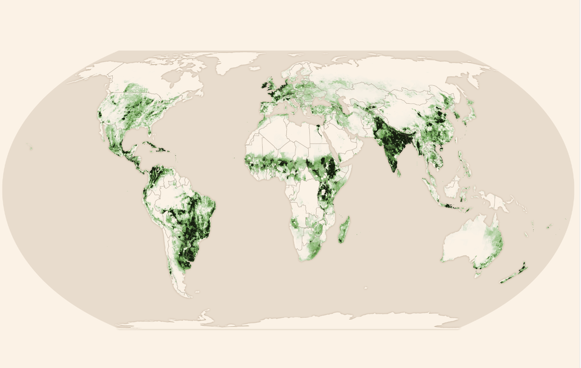

I'm looking through the ESRI StoryMap Team collection of Storymaps for 2019 put together by Hannah Wilber   -- Specifically looking at (Farm) Animal Planet:
https://storymaps.arcgis.com/collections/9d81757581bb4be68ce8de1510bbf923/present?item=1
Using Safari 13.05 (Mac desktop, OSMohave 10.14)  the map in the Sidecar remains static.
It doesn't change while the text scrolls by (I think there are about 6 slides?)  I cleared Safari cookies and tried again.  Nada.
I opened Chrome to view the same StoryMap - there is no problem with Chrome -- the map densities change accordingly.
Is this is Known Issue with the ArcGis StoryMap Sidecar -- but only when using Safari?

Hello Mia -- Thank you for reporting this issue.
This appears to be a problem only when the story is viewed in Safari as part of a collection (as it is in the link you shared above). There is no issue if you access the story directly using this link: (Farm) Animal Planet.
The maps in that sidecar section are static images, so this is not a problem with map rendering. There appears to be a difference in the way Safari loads and displays images in embedded stories.
We'll look into this more and plan to address it in our next release.
