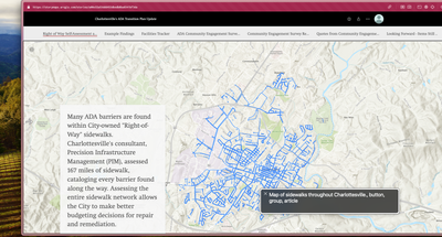

It looks like NaturalReader doesn't read alternative text, but instead, only visible text. Using a tool like VoiceOver on Mac or Narrator on Windows will allow you to actually tab over or select media and hear its alternative text read aloud. Using the story referenced above, I am able to have the alternative text read to me:

My screen reader is reading the text and attribution from all slides in a sidecar. Are you adding those pictures and text on different slides, or all on a single slide within a sidecar? What browser and screen reader are you currently utilizing to test?

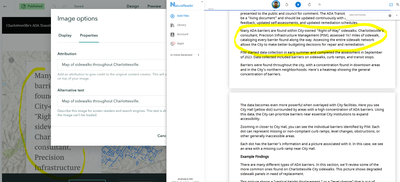

Abby, I have added alternative text and attribution. I also have links below some images that provide URLs that are not spoken by the Google Chrome speech reader or others I've tried, including Natural Reader.
I have been viewing ("reading") it in a published format.
Here's an example showing both attribution and alt text for an image, and it being skipped over by Natural Reader, only reading the text provided within the sidecar's text boxes.

Abby, the Windows Narrator worked for me as well. Thank you for your help in figuring this out!
