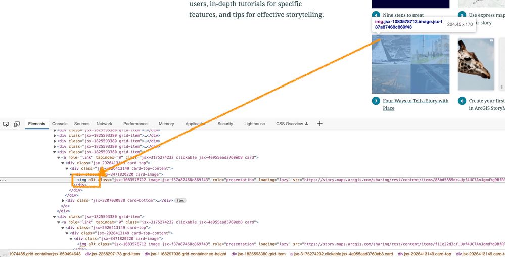

From a technical perspective, as mentioned above, accessibility guidelines say that decorative images should have an empty alt tag in the HTML. This is something that ArcGIS StoryMaps does automatically for you. For example, you can see the empty alt tag on the collection item thumbnail in the screenshot, below.
I believe this should address your concern about the requirement for all images to have alt text, but let me know if you have additional questions.
