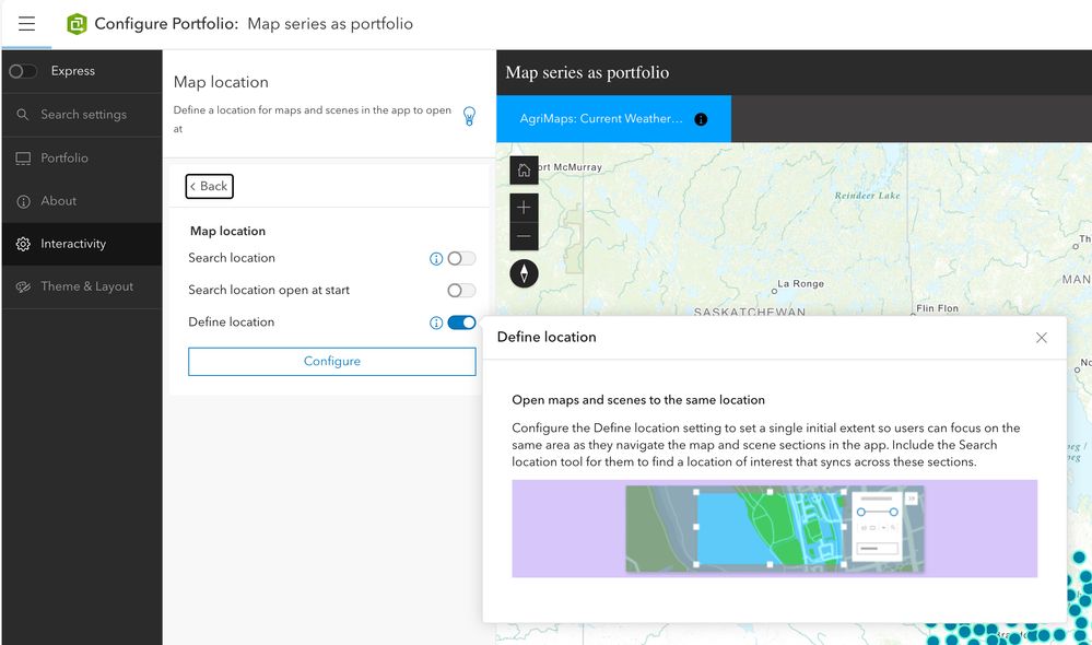

@HaileyWright1 - Thanks for providing your detailed feedback about your experience migrating your classic map series!
I agree that the Portfolio app is the best choice in your case. I think you'll be happy to know that it does have a configuration option to sync set the same map scales extent across tabs. Just go to Interactivity > Map location and toggle the Define location setting on. 
As you noted, you will need to create separate web maps for each tab, so the workflow to create the app will be a bit different. If you'd like to see Portfolio add the ability to override layer visibility, please post that idea to ArcGIS Instant Apps Ideas - Esri Community.

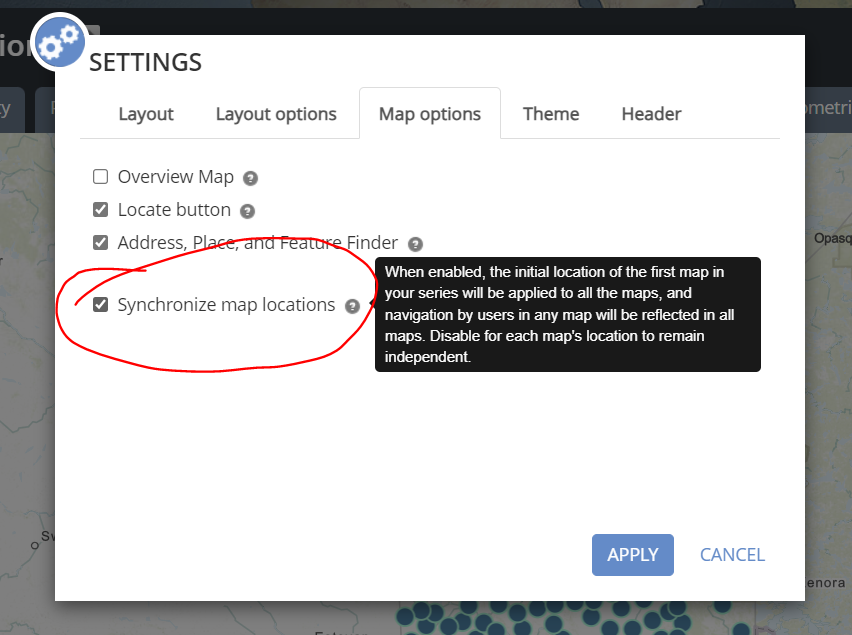

HaileyWright1
@OwenGeo - Greatly appreciated!
Here's another post about this Portfolio Template App - Sync Maps - Esri Community
And a screen cap of the synchronize map locations setting in the map series builder. For my case, Portfolio will fit like a glove with this capability added.
