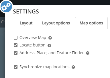

@OwenGeo interesting to follow this thread. I'm in a similar situation with this very map-centric classic story maps map series Waikato Regional Hazards Portal (arcgis.com) that I need to update to the new ArcGIS StoryMaps so it looks and works as close as possible to the original.
Your tips above may prove helpful but one key feature I need from classic story maps and am not sure is available in ArcGIS StoryMaps is the "Synchronize map locations" function.
Is such a function available in an ArcGIS StoryMap with a tabbed series navigation design? Any guidance or tips appreciated.

@DerekPhyn Thanks for your comment about syncing map extents! That is a capability that we haven't yet added to ArcGIS StoryMaps because we've been taking time to listen to feedback about what the customer needs are in this area. We have discussed it and even have some preliminary designs for this capability. We're likely to work on adding a similar capability in the first half of 2022.
Do you have any specific feedback about how you'd like the feature to work? Was the classic version of the feature exactly what you needed, or are there any improvements or changes you'd make?
