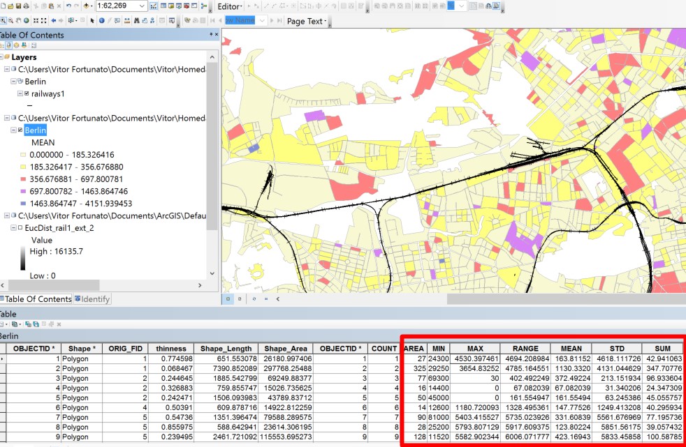

here is a print screen of the evidence:

The result from  Zonal Statistics as Table is a table, and that table will has one required OBJECTID.
in your picture the table has two required OBJECTID.
so I think that the table is modified.
try again the tool and snapshot the original result.

BUG-000095650 Zonal tools using the FID field gives incorrect results.
BUG-000095651 The Zonal Statistics tool is crashing ArcMap and ArcCatalog when the input zone data does not have a raster attribute table.
have been fixed in 10.5
I hope that table is the result of a join after the zonal statistics was calculated and not before it was calculated.  And every thing is in the same projection I hope? and it is projected and not in geographic coordinates... the list of places things can go wrong are numerous.
