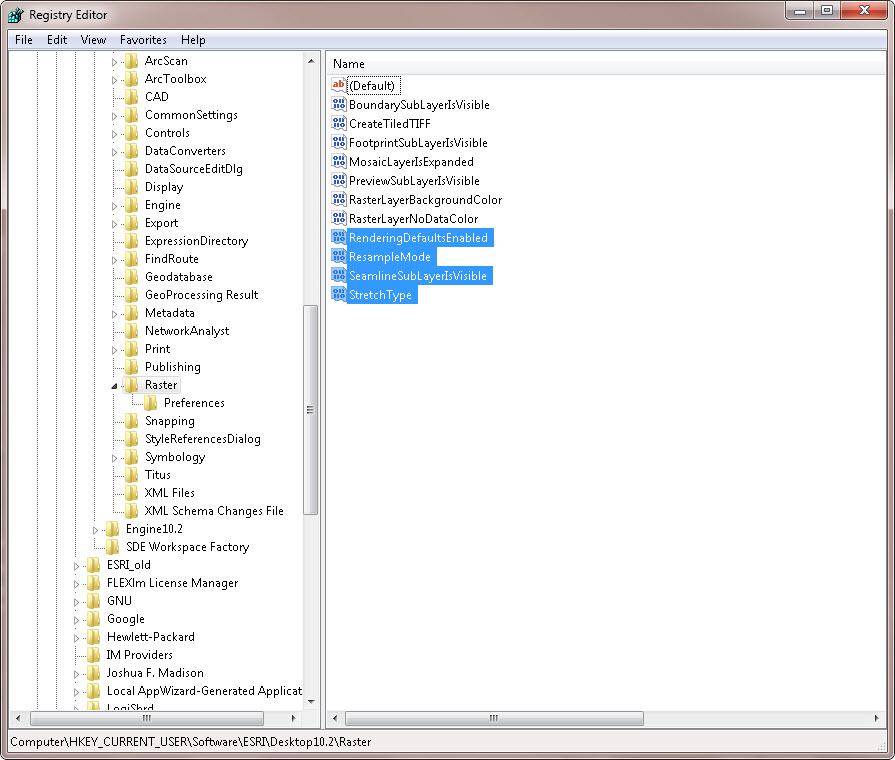

I noticed my 10.3 box was saving the changes so I looked in regedit.
I added these to my 10.2.1 settings and they now "stick".
