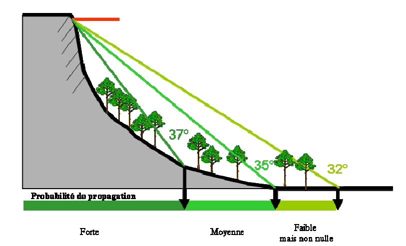

I'm actually working on a project in Madagascar and i have a lot of work do to with rockslide. Some place might be concern by this phenom and i'd like to work on Arcgis to calculate the propagation of blocks from a cliff in my area.
The idea is "simple" and i've done it (in the past) on Mapinfo using topographic profile (with a raster) and then priting the profile and working on it. I'd  like to do this on Arcgis with the software if it's possible.
I have a DTM and a raster with the slopes of my area. I have some cliffs (materialized by a polylign for example) and i'll like to draw a topographic profile in the highest slope. This is relatively easy i think as there is a tool in arcmap to draw this directly.
BUT, i'd like to draw a profile who start from the cliff, and with a certain angle (°). The angle is from an imaginary horizontal line at the top of the cliff. I would like to know where the line (from the top of the cliff) intersect the ground.
An image is better to illustrate (see bellow).

I've done something similar for showing where railroad tracks at different percent grades would need to go into tunnel. You'll want to create a contour line along your cliff edge and assign it the actual ground elevation in an elevation field. Then draw another line well past where you would expect the slope to intersect the ground (make it a nice round horizontal distance like 1000 feet). Then calculate what the elevation would be for a 32 degree slope at 1000 feet out based on your initial elevation and add that elevation to your elevation field. Copy your 2 lines into 2 new feature classes and adjust the elevation based on your other slopes of interest. Then convert your contour lines to a surface (1 surface for each slope) and add to your profile graph along with the real ground elevation surface. You can also use raster calculator to create a surface that shows where the slope is below ground versus above ground.

At the end, i'd need a polygone from the edge of my cliff for my first slope 32° and 2 othes ones for the 2 others slope
