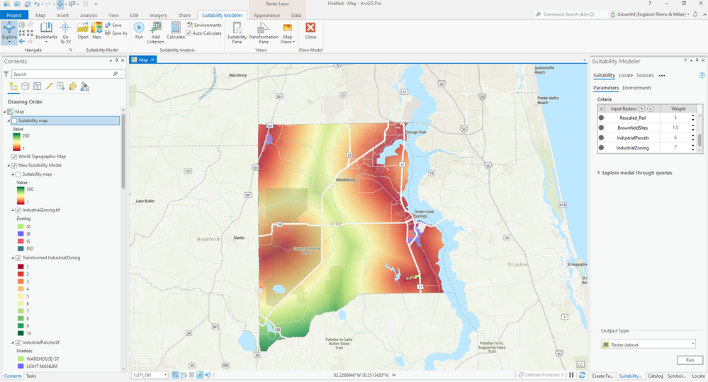

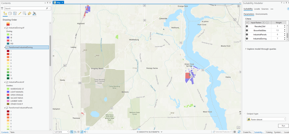

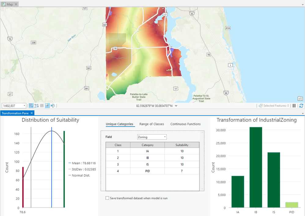

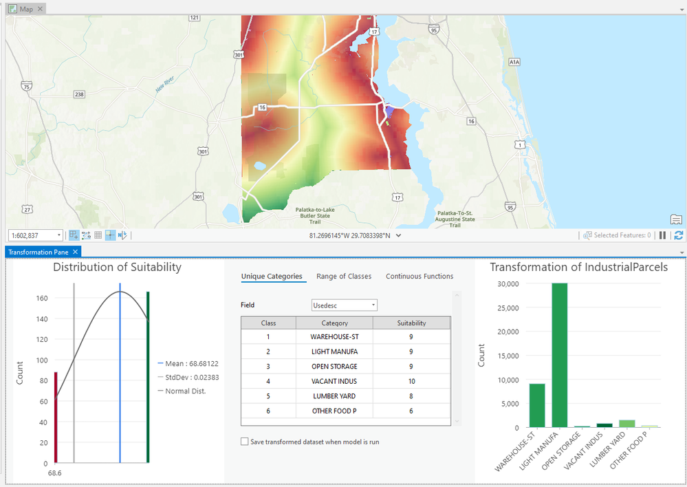

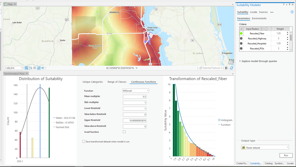

Hi Steve, following up on the thread from late last week. I have ran through my model quickly, in the same workflow as I would normally, in order to take screenshots. You can see here, I can add in my criteria metrics, which are a combination of unique categorical data (land use, zoning, brownfield sites) and continuous data (Distance from Highways, POIs, Fiber lines, etc.)
Below are screenshots of my categorical data (transformation pane), as well as an example of one of my continuous datasets for reference.
You can see the zoning and parcels are features that, before rasterizing, I queried to only have the criteria I want (and then rasterized before adding into the model). Which is why they are scattered, individual pieces. Please let me know if it is better to have the entire dataset in and rasterized, instead of scattered pieces. Below is the resulting output of my model - it is just one small polygon.ModelResults.PNG
When running the model with only the Euclidean distance rasters, the model outputs a beautiful, suitability model (results that one would expect - though I did not attach any here).
Are there any obvious faults I have with my inputs? Or weighting issues you see, etc.? I value any feedback, comments, or ideas you have. Thanks for your time!

Your IndustrialZoning layer has a lot of NoData and this means that no suitability values are created in those areas. I.e if any of the input criteria have NoData in a particular area implies that the suitability at that location will also be NoData.

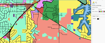

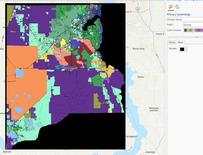

Hi Steve, do you have a workflow or solution on how to remove the NoData from my rasters? You can see in this sample Zoning raster, in which I just converted from vector to raster, and applied a mask, the file has NoData values (in black). Which through your initial answer, are not desired for Suitability Modeler. Or if not, do you have a solution or workflow in which you would apply categorical data into the model, such as zoning or parcel data. Thanks for your time!
Zoning (NoData values in black)Zoning (NoData values in black)Zoomed in, can still see NoData values (in black)Zoomed in, can still see NoData values (in black)
