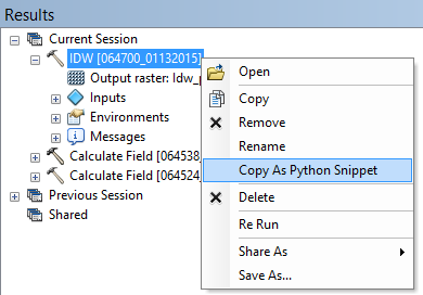

If I do a manual IDW interpolation (Spatial Analyst Tools\Interpolation\IDW) it does appear in the Result window and I can copy the Python Snippet:
Result from clipboard:
# Replace a layer/table view name with a path to a dataset (which can be a layer file) or create the layer/table view within the script
# The following inputs are layers or table views: "points03"
arcpy.gp.Idw_sa("points03", "IDWval", "C:/Users/xbakker/Documents/ArcGIS/Default.gdb/Idw_points031", "4,21920391999947E-04", "2", "VARIABLE 12", "")

If you plan is to run the tool 800 times, you will want to script this. Don't do something 800 manual when with little effort it can be scripted A very easy start is to perform the IDW manually and in the Results windows, right click on the IDW result and select Copy Python Snippet from the context sensitive menu. This will give you the python syntax of the IDW interpolation. Based on that you can start scripting (changing dataset, IDW settings, etc).

I have to perform diffrent interpolation methods and by changing few parameters on three data sets.Almost there are 189 combinations. And the interpolation method does not show any result in the result window. So how to copy as python snippet?
