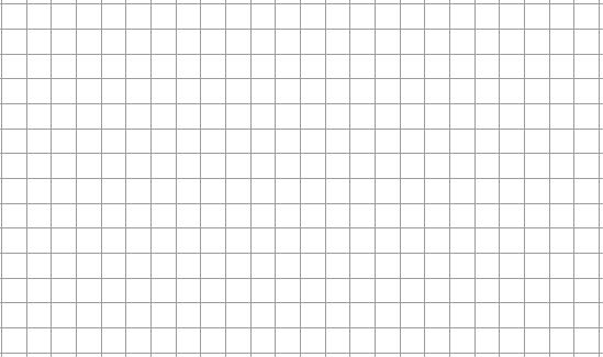

I am using ArcGIS 10.3 with access to advances extensions. There is two features that I have (attached): i) grid (fishnet) of 30 meter:
Grid (30*30 M)

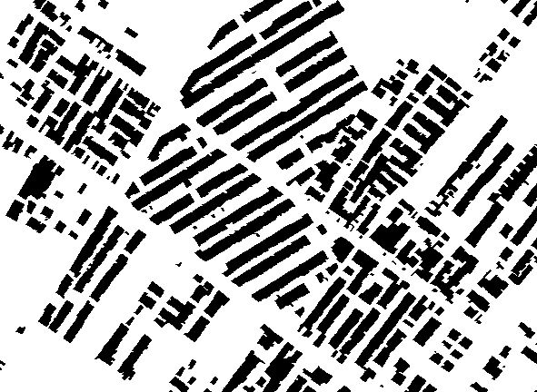

and ii) Building footprint:
Building footprint

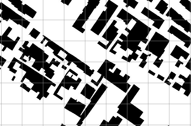

I am interested in splitting/having the building footprint in each grid-cell:
split

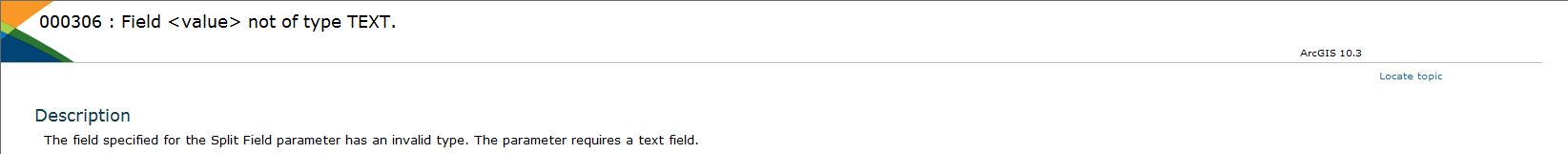

Therefore I have used the Split tool (Splitting a polygon by an overlapping feature). However, the process is always terminated:
error

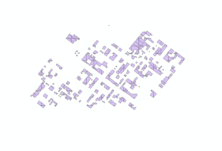

Have you tried union or intersect?  Not sure what you're after, but when I try intersect this is what the resulting polygon feature class looks like:
If you are interested in your Building area, you should capture the two fields before you intersect with BulidingArea_orig and ShapeArea_Orig.  That way you can proportion what you end up with....
That should just about do it....
