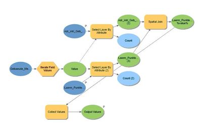

This is in the wrong forum but I'll give it a shot. I think you want to run these using selected sets, that is, select all the IPs and Red points with the same ID, run the spatial join, then choose the next ID, select, repeat. Tools ignore rows in the input layer that are not selected, so this should work fine.
This is pretty straightforward in ModelBuilder using an iterator and the Select Layer By Attribute tool.

Thanks curtvpice! I build a model like you suggested and it runs smothely up until now. I hope ArcGIS doesnt crash. I collect the values at the end of the model to feed them into a merge as part of a major model. What was also really helpful was a similar answer I got on stackexchange: https://gis.stackexchange.com/questions/403834/spatial-join-with-if-operator-and-closest-match-optio...Unbenannt.JPG
