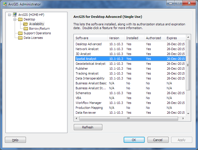

I'm not having any luck getting Spatial Analyst (specifically Spline Interpolation) to run on my ArcGIS for Home installation.  I show it as installed and authorized:

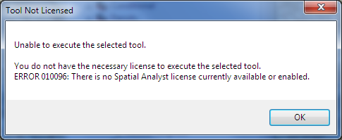

but when I click on the Spline tool, I get:
Is there a separate step for using/licensing this tool that I missed?  Thanks for your help.

Do you have the extension checked on?
In desktop, under the Customize Toolbar, Select Extensions and make sure it us checked.  ArcMap and ArcCatalog act independently, so you will need to check it in which ever software you are using at the time.  Since all the extensions come with home use, if it was me, I would just check them all on.

DavidMeek1
Rebecca, that was it.  Thank you.
