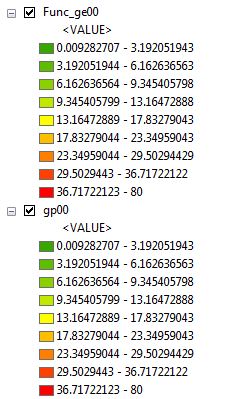

It's not a symbology issue, i used the import symbology. It's the same classification.

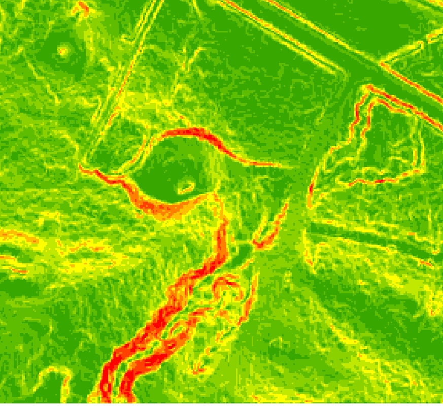

I Did subtract the two raster. There's big differences. Mostly where slope are higher.
Looks like ESRI is using a different formulas.

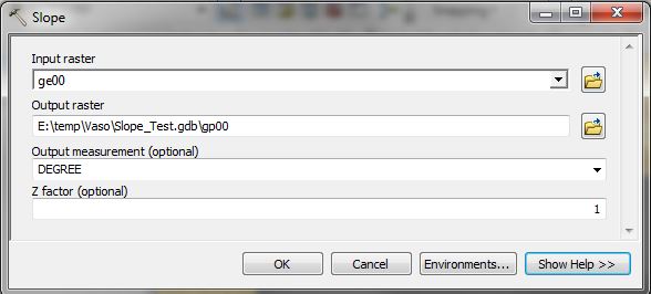

AlexandreLavoie
Step by step:
1. Slope with Spatial Analyst

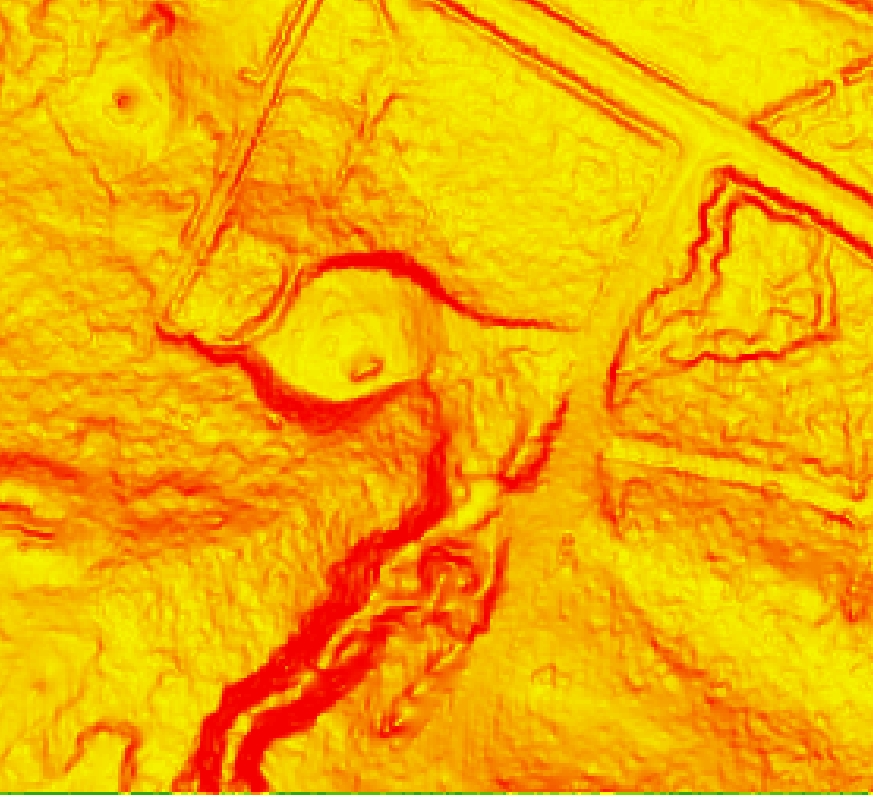

2. Slope with Image Analysis
Result gp00:gp00.jpg
Result Func_ge00:
Same Symbology
I really think the formulas are not the same!
Alex
