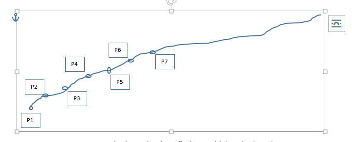

KunomBersh
Thanks Dan Patterson, your input is helpful all the time , but I need to go further, please refer drawing
The intention is to find out which point has slope percentage out of the range (-0.05 to 0.05), if the average slope from p1 to p2 is in the range “pass or ignore”, and compare p1 to p3 if the slope within the range, jump to compare p1 to p4 if the slope is out of the range, record p4 as deflation point, then start compare from p4 to p5, if it is within the range pass, compare p4 to p6 if it is out of the range record p6 and then again start from p6, and compare p6 to p7  so on….the deflation point will be the starting point for comparison with the next point, if we have millions of points how we can automate using python.
