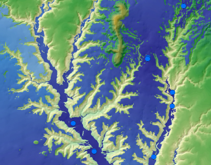

Yesterday I performed some steps on the dataset provided by Andrew. See them listed below:
# Create a hillshade for visualization
arcpy.gp.HillShade_sa("ned10m34101g3","C:/Forum/Pasture/gdb/Pasture.gdb/HillShade","315","45","NO_SHADOWS","1")
# Calculate the slope in percentage based on your DEM ("ned10m34101g3")
arcpy.gp.Slope_sa("ned10m34101g3","C:/Forum/Pasture/gdb/Pasture.gdb/Slope","PERCENT_RISE","1")
# Reclassify the slope in two classes 0-15% and >15%
arcpy.gp.Reclassify_sa("Slope","Value","0 15 1;15 159,99526977539062 2","C:/Forum/Pasture/gdb/Pasture.gdb/SlopeClfy","DATA")
# Set those areas to NoData that have a slope > 15% (value = 2)
arcpy.gp.SetNull_sa("SlopeClfy","SlopeClfy","C:/Forum/Pasture/gdb/Pasture.gdb/SlopeSetNull","Value = 2")
# Calculate the cost distance from the water points, using SlopeSetNull as cost raster (slopes > 15% are inaccessible)
arcpy.gp.CostDistance_sa("Water","SlopeSetNull","C:/Forum/Pasture/gdb/Pasture.gdb/CostWater")
The result looks something like this (accessibility calculated from water points are represented with blue area):
