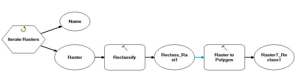

Hi Michael,
You could use the following workflow.
1) Use model builder to convert the rasters into simple polygons
     a) Use Iterate Raster.

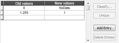

     b) Reclassify the background value (e.g. 0) to NoData, while rest of the values (255 is the maximum value among all raster data, in my example) to 1.
     c) Convert the Raster to polygon.
2) Use intersect (Analysis) to get the common area of interest of all the polygons.

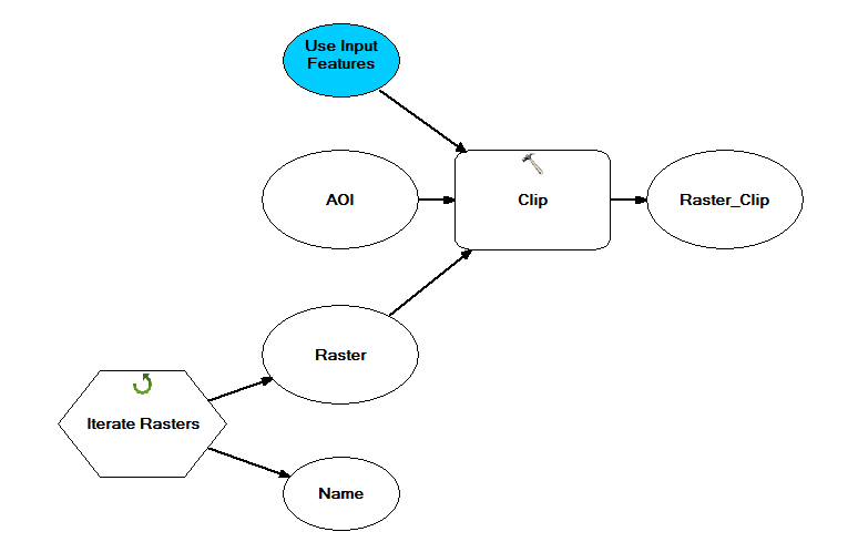

3)Use the above intersected polygon to intersect the rasters.
Thanks,
Jay

Yes! Ok, the model builder is exactly what I want to do. I built the model as shown but I am getting the error...
" ERROR 000581: Invalid Parameters. Failed to execute (Reclassify). "

Could you send a snapshot of the reclassify tool in Modelbuilder

Alright, so I got this model to work beautifully (Tip-of-the-hat to Jayanta Poddar).
So ignore the error message I recently posted.
