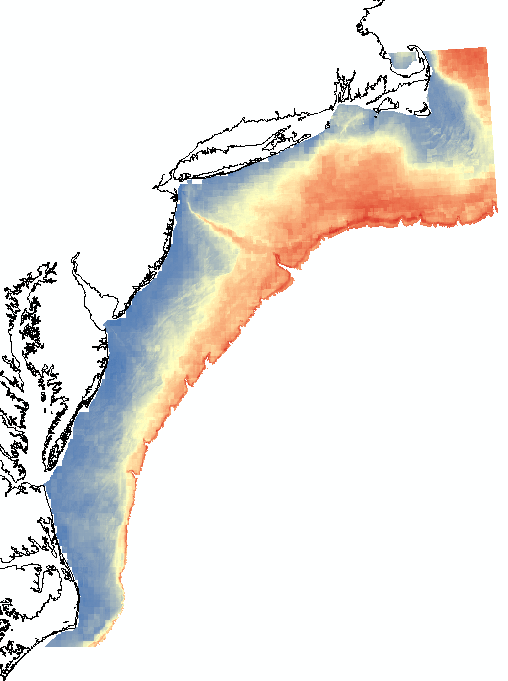

What I'm unclear on is what PCs mean in terms of the multiband raster output from the Principal Components tool. I can look at my Eigenvalues for each PC and determine how many to use to maintain the variation in my dataset, but I don't know how to interpret the PCs in raster form.
For example, here is PC1, with values ranging from 4.6 (red) to 0 (blue). What do these values mean? My best guess is that these values are 'distances' or errors from the PC1 axis.

Thanks - that is a great link to a very clear and concise explanation of a PCA analysis. But I still don't understand what the raster PC pixel values are, or how they are calculated. PC1 is an axis along the direction of greatest variance (side question: because I'm working with spatial data, are directions true directions; e.g. the direction of greatest variance denoted by PC1 above is inshore -> offshore?), but what does a high pixel value mean vs. a low pixel value?
If I were to hazard another guess following: pca - What are principal component scores? - Cross Validated , I'd guess that each pixel value is a PC score. In other words, a given pixel(x)'s value in PC1 is a linear recombination calculated as the product of var1 at pixel(x) * var1 loading for PC1 and then summed across all variables at pixel(x).
Following this logic, a pixel w a high value in PC1 likely had original variables with high values that loaded heavily in PC1 (because multiple sums of a big variable value * a high loading would lead to larger numbers). So I guess I would interpret PC1 as representing original variables that were generally low valued inshore, and high valued offshore.
Am I on the right track?
And if so, it begs a  follow up question: why are none of the PC1 raster pixel values negative? A given variable can load negatively w a given PC: if linear recombination is how pixel values are calculated, some could be less than zero. Does Arc include some sort of standardization in the calculation?

My understanding is that the variation in layers that load heavily with a given PC; i.e. layers that have high positive or low negative eigenvectors, is captured by the given PC. Layers with high positive eigenvectors are directly related to the PC; layers with low negative eigenvectors are inversely related. For a given PC, a high pixel is a location where layers with high positive eigenvectors also had high values (direct relationship). A low pixel is a location where layers with low negative eigenvectors has high values (inverse relationship).
I tested this by running a PCA on a very small number of input layers so I could easily observe the relationships between inputs and PCs, and it holds true.
Does anyone see any flaws in this conclusion?
