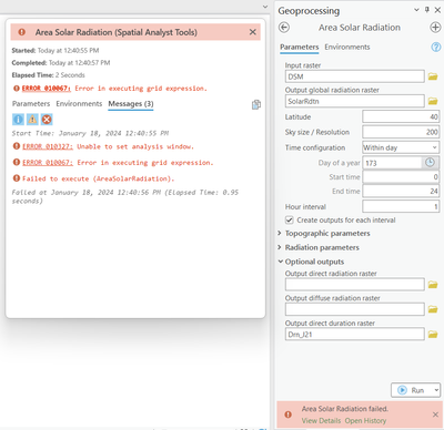

I tried to run the Area Solar Radiation tool and got the same errors:
ERROR 010327: Unable to set analysis window.
ERROR 010067: Error in executing grid expression.
Failed to execute (AreaSolarRadiation).
Could you please let me know how you solve the issue exactly?Screenshot 2024-01-18 124119.pngScreenshot 2024-01-18 124119.png

Hi Rachael. This was an old issue but looked to be solved by making sure the output workspace or scratchWorkspace is set to a valid file directory or geodatabase. Make sure you have write permissions.  Are you able to run with additional tools or input data?
What version of ArcGIS are you using?   If using ArcGIS Pro 3.2 or greater I'd recommend using the Feature Solar Radiation tool or  Raster Solar Radiation tool which provides enhanced functionality and performance.
