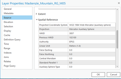

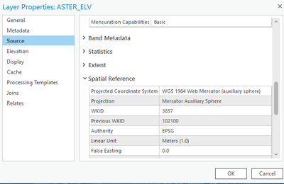

RabeccaThiessen
I have checked the point file and the raster they have the same spatial reference:

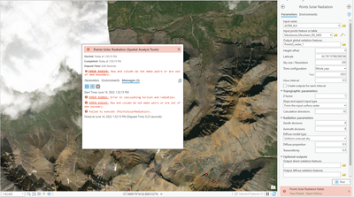

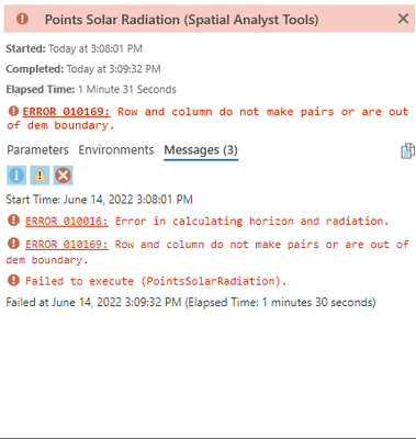

 I ran the tool again with the environment set to "same as display". Here are the errors now:
RyanDeBruyn
The error points to a data issue.  You'll need to ensure the point data were created in the same projection as the DEM.  How were the point data created?

The coordinate system and the projected coordinate system are the same for both the DEM and the point layer

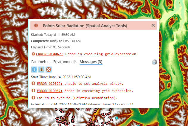

I have now converted the lat and long fields from the point layer to ASCII table and subsequently used this for the input on the point solar radiation. This came up with errors again:
The points are definitely within the DEM extent
RyanDeBruyn
Seems like there is some disconnect with the defined spatial reference and how the spatial points are being created.
There are different ways to create input point layers from a set of coordinates if you have them without doing it manually.
Check out the Make XY Event Layer tool  if you have a list of X,Y coordinates.   Can also take advantage or convert Excel To Table (Conversion) tool.   You can then use Project or CopyFeatures (with environment setting)  to set the appropriate coordinate system for you final output.
