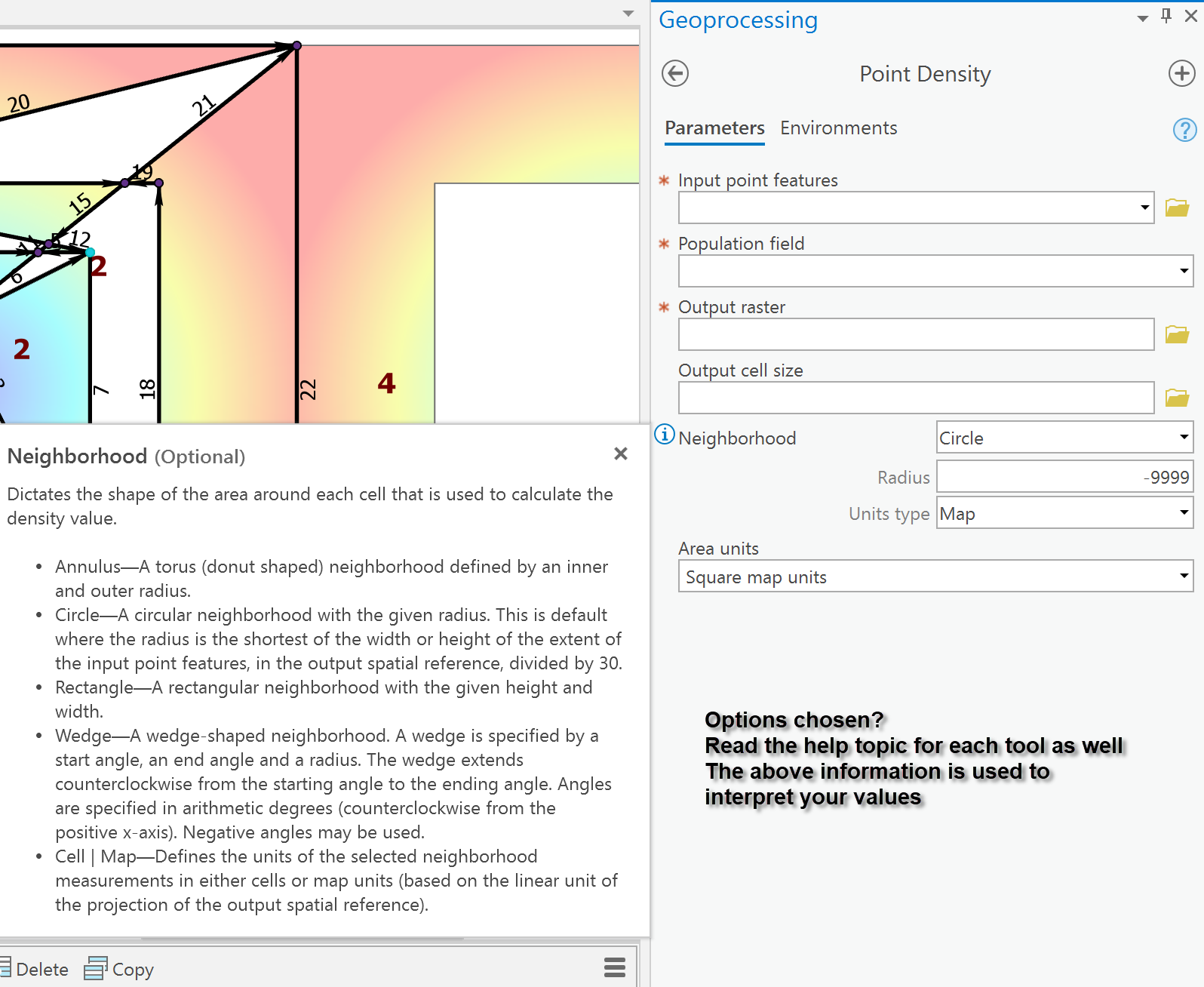

DanPatterson_Retired
MVP Emeritus
That would depend on the options your have specified.
Even 'defaults' have their implications and require interpretation.
