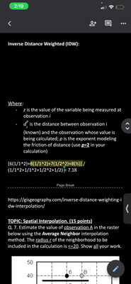

Sheikhkenneh
Need assistance with this question I was given

the question is asking for the raster value at the intersection of 4 raster cells? Not your fault at all, but that confuses me no end.
Sheikhkenneh
I believe so. I have no idea what points to use or how to find the distance with the things given .
DavidPike
MVP Notable Contributor
I think @DanPatterson can offer some academic input on this one.
DanPatterson
MVP Esteemed Contributor
That is merely a cartesian plot of the points, not raster cells.
The x and y axis show spacings of 1 unit for distance, so for a horizontal or vertical movement you are moving 1 distance unit.  a diagonal movement would represent sqrt(2)  (pythagorean theorem).
You must decide which points to include given that the distance values must be <= 2.
Pick the points to include and use the equation to sum the distance values etc...
Since it is a problem presumably for a course, I will leave the solution to you... make sure you show your work.

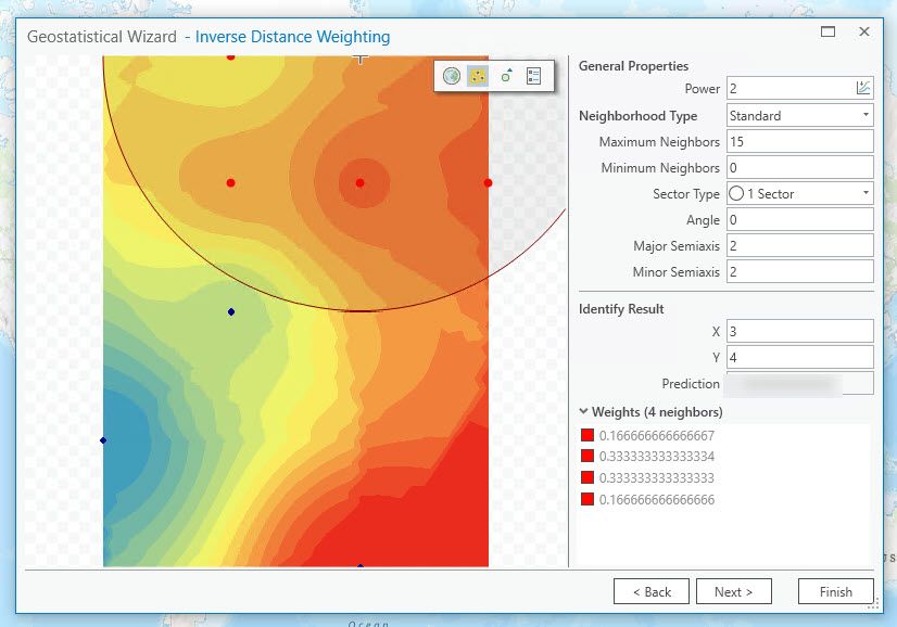

SteveLynch
Interactive Geostatistical Wizard is also a great teaching tool. I've hidden the answer as this is an assignment 😀
Sheikhkenneh
 did I do this correctly?
