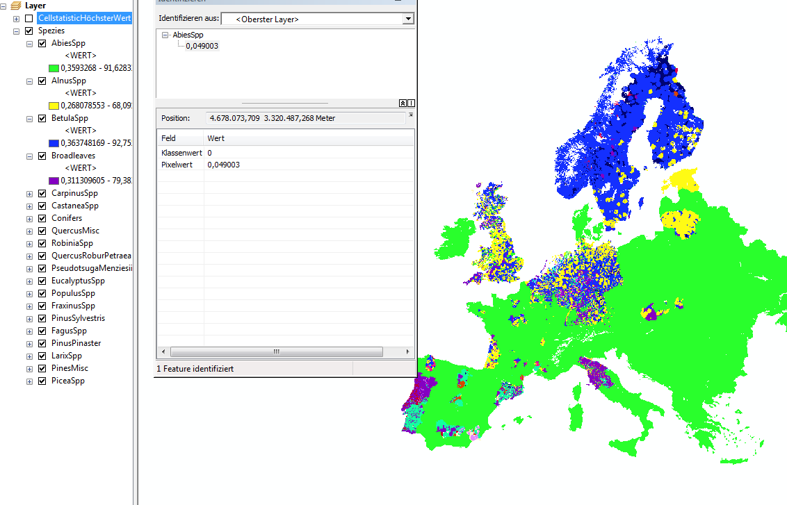

Hello,
I'm just starting to work with the software programm ArcGis and want to merge about 20 different rasta files containing the distribution of european tree species. They all have different values related to their distribution level, i want to combine them in one layer but only the dominant species, should be presented, so if there are different species in one grid cell only the one with the highest value should be presented, furthermore I want to make a time-related map, using a simple coefficient, just saying that for example broadleave areas are shrinking since the 1950s.
Best regards and thanks for the help.
F. Schwarz

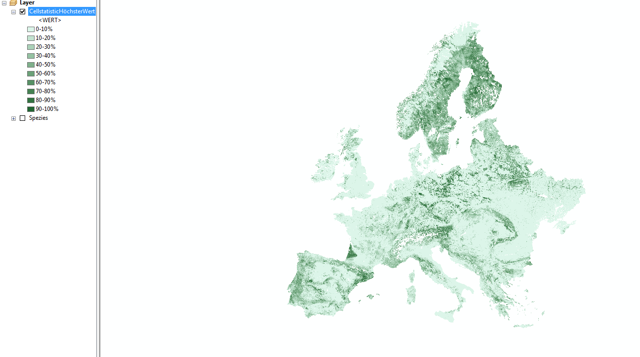

let's start with cell statistics using maximum to get the raster with the max at a location
FelixSchwarz

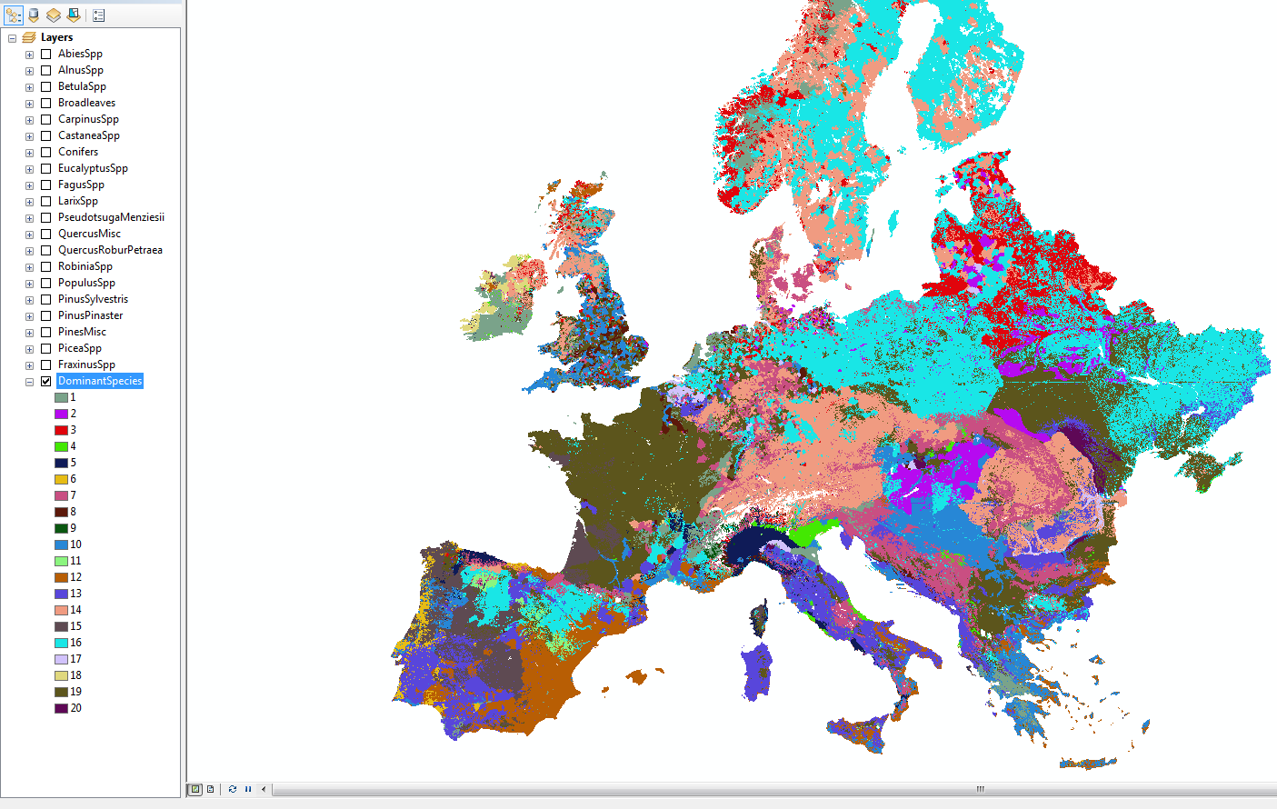

But after cell statistics using maximum the data is already merged in one file. In the end it's supposed to look like this, but I don't know how to get there.

FelixSchwarz
There is no time data included yet, I Need to create new time data but at the moment I just want to sort them after their Pixel value at a first step right now they are just sorted after their listing, so always the layer that stands at the top is shown, but the layer with the highest pixelvalue at one spot is supposed to be represented in the map.
After using cell statistics they are all merged in one file, but not seperated, so that I can not Change for example the colour of one single species.
