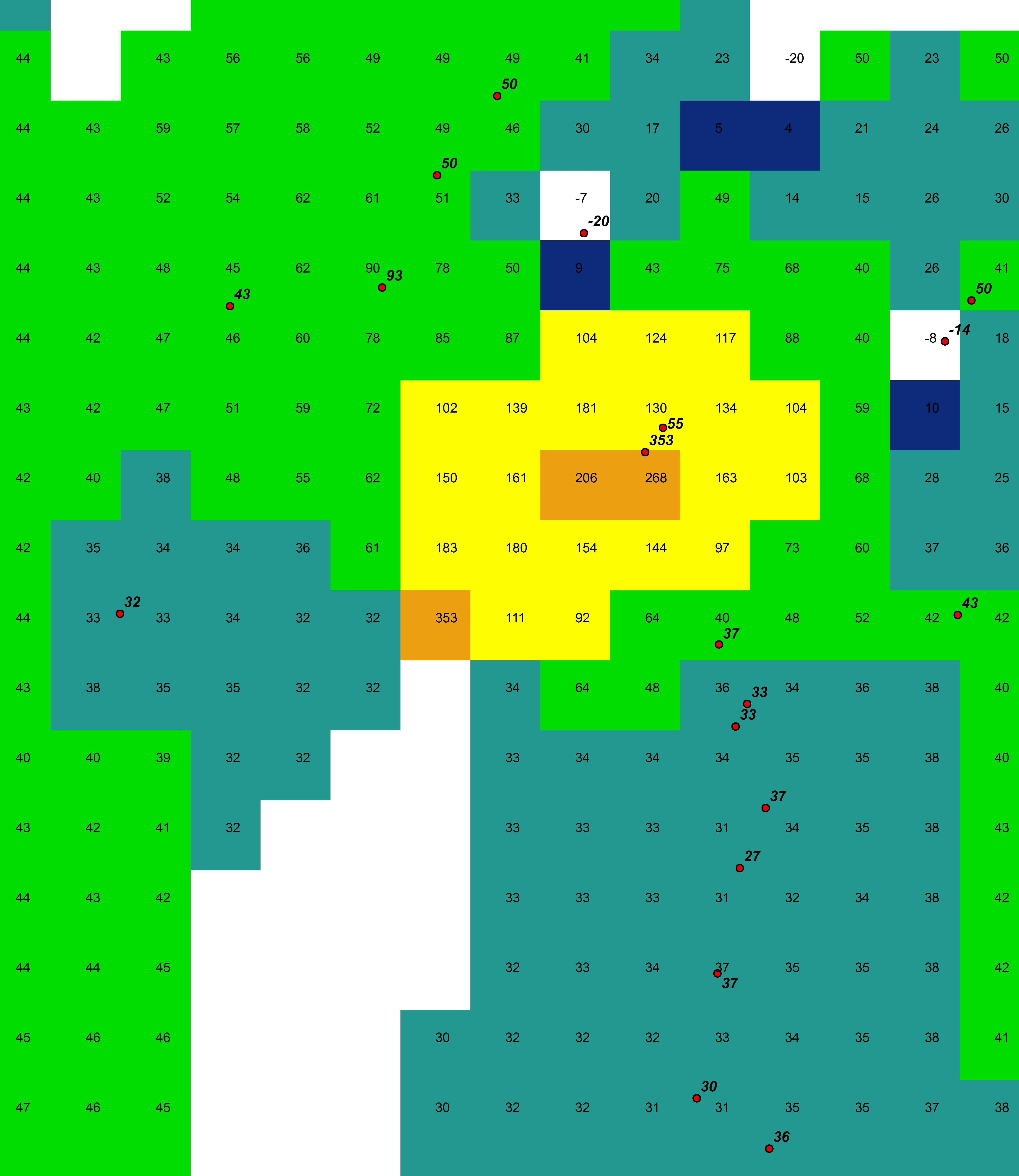

Hi there,
We have produced an interpolated map using the IDW tool from the Spatial Analyst extension, with a cell size of 1,000 meters and a fixed distance of 4,000 meters. Other parameters are defaulted. The attached illustration shows a detail of what seems like an abnormal result: Sample sites are indicated with the red circles with their value in bold italic face. The IDW cell values are indicated in the cell center. Could anyone explain why is there a cell with a value of 353 in that cell by the center of the figure, when there are no high values in the vicinity. What is the source of this artifact?  Thanks for your help.

Thanks Adrian for your prompt answer. I tried with IDW variable distance, krigging, and natural neighbor from the SA, and IDW standard circular with a radius of 4000 from the Geostatistical Analyst, always keeping the same cell size (1,000 m) and these methods do not show that behavior. It seems to be happening only with IDW fixed distance. It also happens at some boundary cells, where there are no more data points, as in the illustration included. Is that weird or explainable?IDW_Edge_Ex2.jpg

I suspect it is that only two points were found within the search radius How IDW works—Help | ArcGIS for Desktop
but if you read the text in fixed radius it isn't quite as clear as what you think.  It is unfortunate that your observation points are sparse and when you do have them, they are closely spaced together.  You have a good combination of unsatisfactory conditions particularly for an IDW that limits the search radius and number of points

As I understand it, IDW would extend the search radius if no data points are found within the specified search distance. Is not clear to me why there is a higher cell value with surrounding cells that are either lower than the 353 outlier or null values.

The problem in using IDW give your point distribution, even if the search radius increases lies in the fact that the interpolate locations are for the most part far removed from the point locations.  You would have to obtain what points were used in determining the value for that cell their distance to it and do the math.  I suspect that the influence of that 353 value in the bigger picture of things is quite small.  IDW is not the interpolator to use.  In fact, I might even suggest that given tight point clustering and large distance between clusters is going to be difficult to interpolate anything meaningful  other than as a mathematical venture.  Other approaches like voronoi diagrams, various density calculations might lead to a more informative surface.  Of course such conjectures could be mitigated by an understanding as to the purpose of the interpolated surface... is it to show pattern, containment, locality of occurence and a variety of other things.  In any event, the math is available from a variety of sources and could be used to assess whether there is an error in the calculations or whether not enough information is provided to determine which points get included during a radius expansion.  That is one reason that I suspect that the Geostatistical analyst offers more flexibility of weights, point inclusion and even such things as the directionality of inclusion.

I have checked the coincidence of data points with different values and it happens in a few cases somewhere else in the area but in those cases the resulting grid is approximated to the average of those points. I appreciate the suggestions to evaluate other methods and I have actually done it but I like the "control" we have in terms of restricting the extension of the search radius and having those cells with null values where there is no data while the other methods still interpolate over those areas. Perhaps I could just use one of those and build a buffering mask to clip the result. Independent of that, I still wonder why this abnormal high values show up.

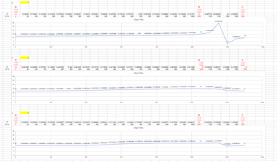

Hi,
Maybe it have something to do with this:
recently I've been playing around trying understand the affect of Power in IDW
using a 2d excel simple example with 3 points.
I have found unexpected behaviour while the P =1 (actually any Odd power value gives quite similar strange result, but especially p=1)
Guess it may be kind of an explanation for the phenomenon you are describing.
